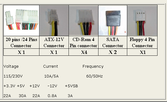

Ok so i propose to up it to charge a backup battery, sort of a rudimentary UPS . So all i would need to do is design a charge controller and it would work, in theory? Here are the specs for the supply i would use.

I don't know that much about computer power supplies. One concern is that a mostly discharged lead-acid battery requires a current-limited power supply'; both to protect the battery, as well as preventing blowing up the supply. I suspect that a computer supply would blow-up if overloaded.
If you can tweak up the 12V output to ~14.2V, then it could make a charger, provided you can limit the current to no more than about 20A.

Err, modern computer power supplies have moved over primarily to putting power on 12V rails as per the newest ATX power specifications. My power supply, for instance, has 20A @ 12V available on 4 rails. The 5V line has become rather wimpy now. Just wanted to chime in.

As others have mentioned, the +12v rail on older power supplies does not allow too much output current, but then again you can charge with less if you like anyway.
The +12v rails on the modern supplies (also mentioned in previous posts) put out much more, like 14 amps and up. The real problem though is (as mentioned) the voltage is only +12v and you need about +14v to charge a 12v lead acid battery.
