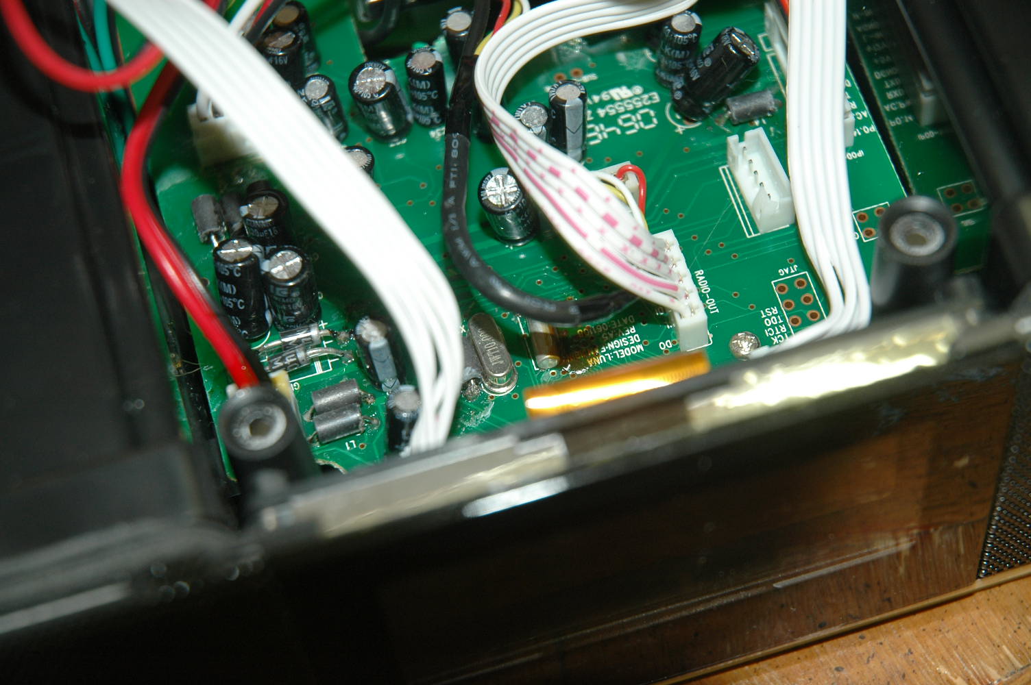

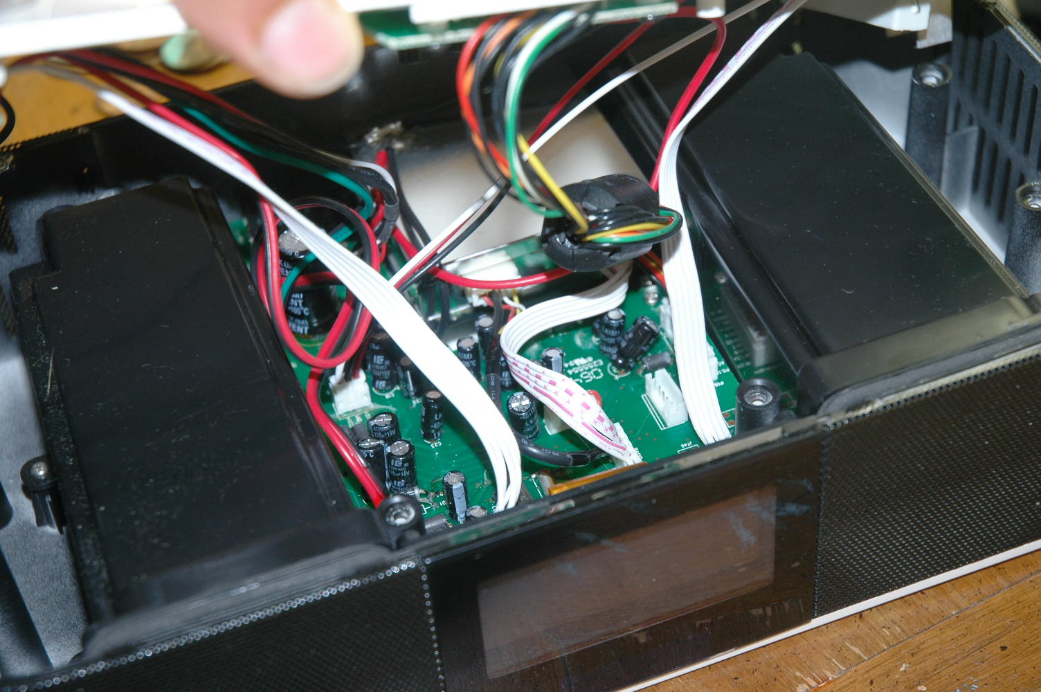

I have a ipod dock with a clock some may know it.. it's the Xtreme Mac Luna.. anyways I've had it about a year now.. but one of the things I noticed is the time keeping on this thing sucks... I was late to work one day because of it.. In about a months time the time will be about 5 min off.. I set the clock about a week ago and it's already about 1 minute off now.

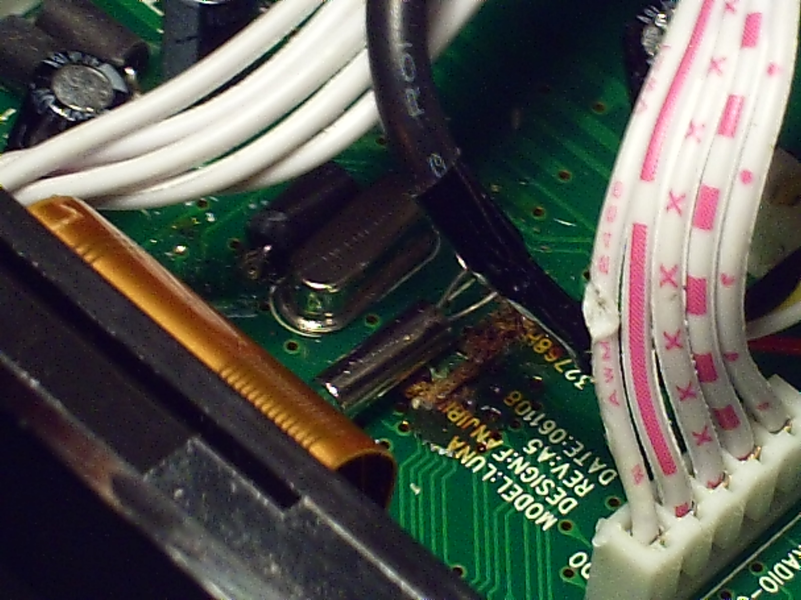

So what I saw inside when I opened it is a 10khz crystal and the 32.768 KHz crystal.
I don't have a oscope to test it but the simple thing to do is replace the crystal?

hmm 4.3 minute error over a one month period.. sounds almost like my issue..

Sounds like typical clock drift to me.
Clock drift - Wikipedia, the free encyclopedia
Even some of my very expensive large mainframe servers at work drift, some worse than others. That's why we use NTP to synchronize everything. I wouldn't imagine that a somewhat cheap consumer device would have that much added circuitry for extremely accurate clocking.

I don't care about it being 100% right 100% of the time.. I don't feel I should be loosing 1-2 min of time each week.. It will never gain time but will always get slower and slower.. at one point it was 5 min behind in just 3 weeks!
if you use a trimmer cap, a cap between one pin and ground will slow it down, a trimmer cap in series with the crystal will speed the clock up, just keep that in mind when you go to make any changes in the circuit. if it's running slow, the cap should be in series, which increases the frequency.

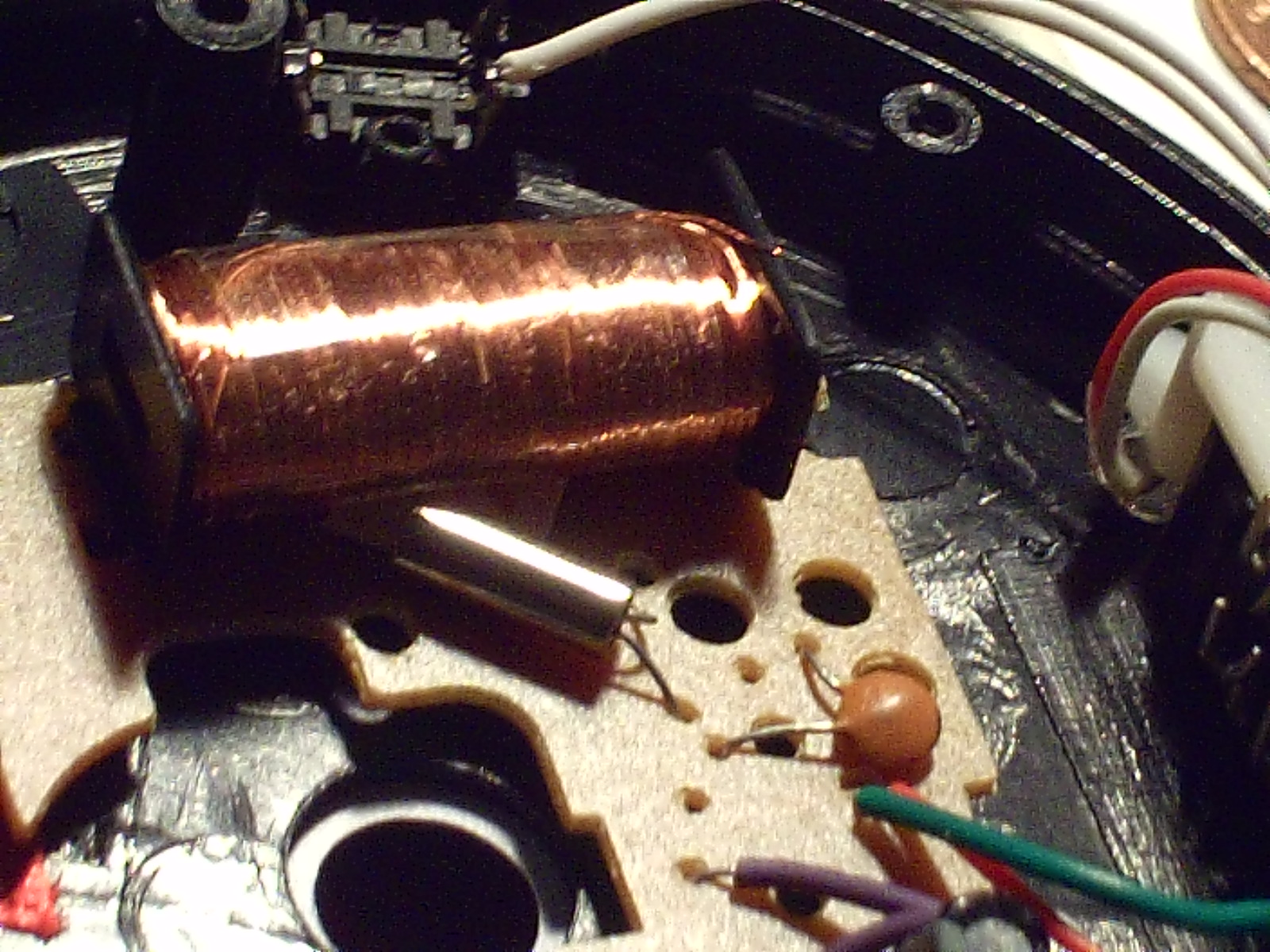

well I changed the crystal first.. I brought a cheap clock which also gave me 2 free tact switches... but replaced the crystals I will report back in a few weeks on how it's going.
first picture is from the new clock taken apart and the 2nd is where it went into.
