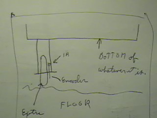

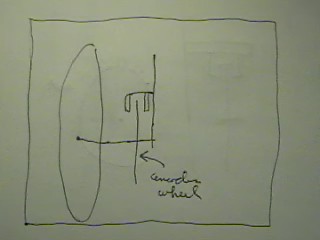

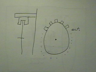

well i was thinking , it has wheels , right ..?
you could easily convert wheel movement into distance..
just hook up an ir transmitter reciever pair to an encoder wheel
please excuse the crude drawings..

in the third pic labeled pic 2 .. lol
bottom left says "extra wheel" or it did say that till i took the pic...
anyway the idea is to hook another wheel onto the cart bottom with an encoder also on the shaft and the ir reciever attached to the wheel support...
