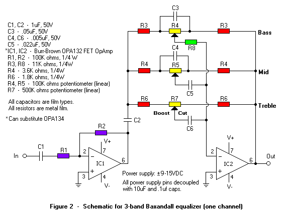

Here is the two page schematic of my hearing aid that Audioguru helped me with the design. I purchased all the parts but before ordering a board I want to double check my schematic. Its all smd
it has two front mics and two rear mics. If you have ever worn hearing aids you will realize that they amplify EVERYTHING so having a conservation in a noisy environment is imposable unless you can turn off the rear mics.
feel free to use if you need a cheap ($50) hearing aid instead of say $5000 per pair. My issue is the average hearing aid has a life expectancy oif 2.7 years. At $5000 it is a questionable purchase but a must buy, I plan to use this hearing device only while in the shop or cooking at the county fair (heavy sweat conditions)

1) You forgot to bias pin 3 of the quad opamp like I showed in April and its coupling capacitor value is much too high if the bias resistors are 100k each.
2) I can't read the part numbers on your schematic. The value of 10uF for C28(?) is much too high. It was 0.01uF in April.
3) The mic has a single 2.2k bias resistor in April but now it is two resistors.
4) The original tone controls circuit uses a 500k pot for treble (the one on the right side of your schematic).

THANKS I have made so many schematic revisions that some items slipped by.
I though I had it all corrected but??
corrections made
I see where I messed up/got lost
I need to check if I ordered the 500k pots smd. as well as the 2.2k resistors.

found another mis connection it was late
I discovered early this morning that I had the inverting inputs connected to bias and not grd via R6/C12 and R13, C16
