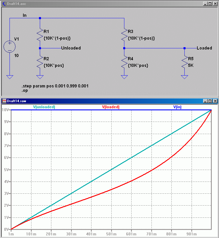

The voltage across the pot is not changed. It is the voltage of the source signal.The pot is a variable voltage divider. Its divided signal is its output to the amplifier.
Here is a LTSpice sim of two 10K pots, showing how the voltage at the wiper varies as a function of the position of the wiper (Parameter called "pos"). Note how the pot resistance above the wiper gets smaller at the same rate that the resistance below the wiper gets bigger. The independent variable of the simulation is Pos, which varies from 0.001 to 0.999
I included two cases; one where the pot wiper is not loaded by an external resistance, and the other where the pot wiper is loaded with 5K to ground. Note the linearity of the unloaded pot (i.e. a "linear" pot) and how the output voltage vs wiper position is shifted by having the pot drive a low resistance.

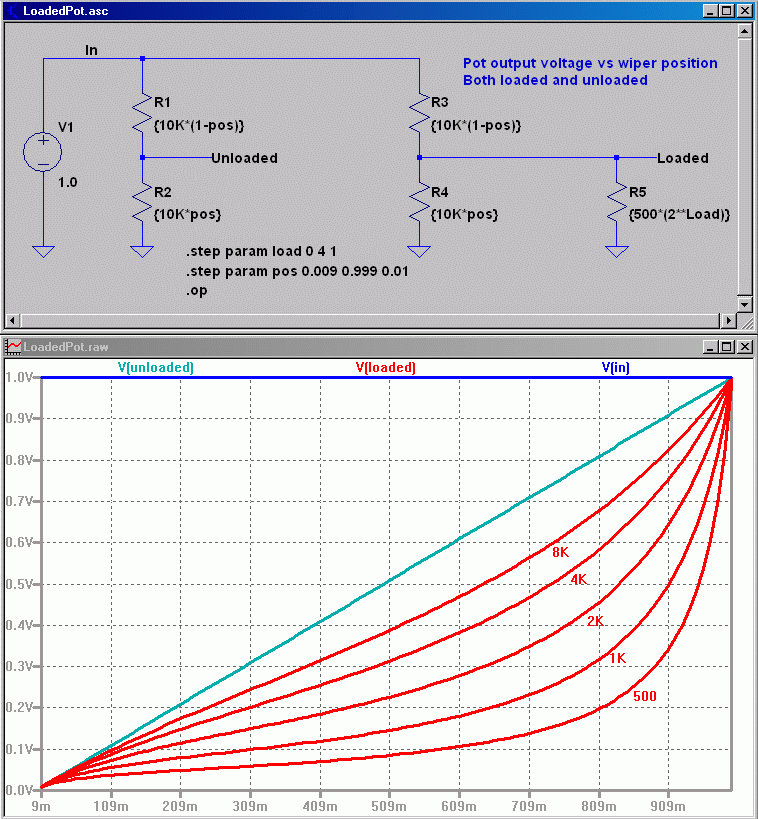

I redid the pot sim to include different load resistors by adding a second variable (the load resistance in binary steps from 500 to 8K Ohms) to show a family of output curves.
The connection that MikeML shows with a resistor to ground generates an approximation to an "audio taper" or log pot which is often desired for a volume control.
