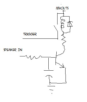

The plan is to tap a speaker in the rear/trunk with no major load to the speaker we tap, with a circuit, and power a relay to turn on the power to the subwoofer amp.
I need ideas. Tap a speaker, see if there is AC/audio. I was thinking a 1:1 transformer to a power transistor to the relay coil. Maybe an opto-isolator..
Anyone have a design or ideas. I have not put a meter on the speaker to see if a DC offset is there with the radio on or looked to see what the audio levels are.
Looking for simple. I have TIP 30/31/32 and 6 amp N/P channel FETs..

speaker* to resistor to cap_ground/base_transistor_NPN I take it. And emitter to ground and add coil/diode/resistor on collector to 12V?
I can't remember if the "turn on" wire of an amplifier needs to be grounded or positive to turn on an amplifier. A single transistor with a resistor from its collector to the positive supply will provide a ground output when it is turned on, add a second transistor circuit to it for a positive output.
Audioguru, it is positive. I drew it out tonight, if I am no buried in works I will hook it all up tomorrow. listen for a relay click, all good, hook it all up. Starting with a 15K resistor to be safe. On the cap, 100uF to start, will see what I get heat wise :)

First try is speaker + to a 15K and 100uF to ground, tap them to the base of a TIP ??? (will look them up in the morning). Emmiter to GND and collertor to coil with diode and a 100 ohm (5 watt plus) to battery. And check voltages and go from there.

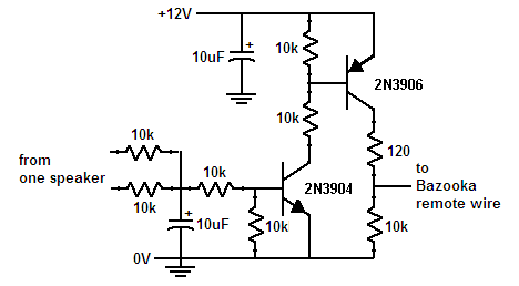

If a rear speaker is driven bridged then both wires have signal and if two resistors add them then the signal will nearly cancel, which makes filtering easy. Then a two-transistors DC amplifier is needed to amplify the 6VDC to 12VDC to feed the trigger wire.

I was going to tap one side of one speaker, then work with that. Something like attached.

The owners Manual for the Bazooka A200 shows 10 different models. Most have an orange wire terminal labelled "remote". The instructions say to connect it to the radio's antenna power wire or to the car's accessory power terminal so that it gets +12V when you want the Bazooka to be on.
I sketched a circuit to take the 6V from an existing speaker and make +12V from it. Any little NPN and PNP transistors will work. Even Canadian ones.:D

Never thought about the antenna, but I think the power will die once it is up, maybe not. I like the circuit idea better though. And all standard parts. Will build it now.. Thanks ag

Took over and hour to get it working. Eagle defaults are too thin of a trace. I normally bump it up one size. This time I did not. Mistake. I patched it up with some wirewrap..
Works great.. Might thicken the traces and add large pads for the big car wires so if I have to so this again it will not be such a pain. Board was about 1.5x1.5 inches...
It works like a champ. And looks like a small current draw when not running.
I am glad to hear that it works well. When the radio is turned off then the transistors are also turned off and don't draw any current.
