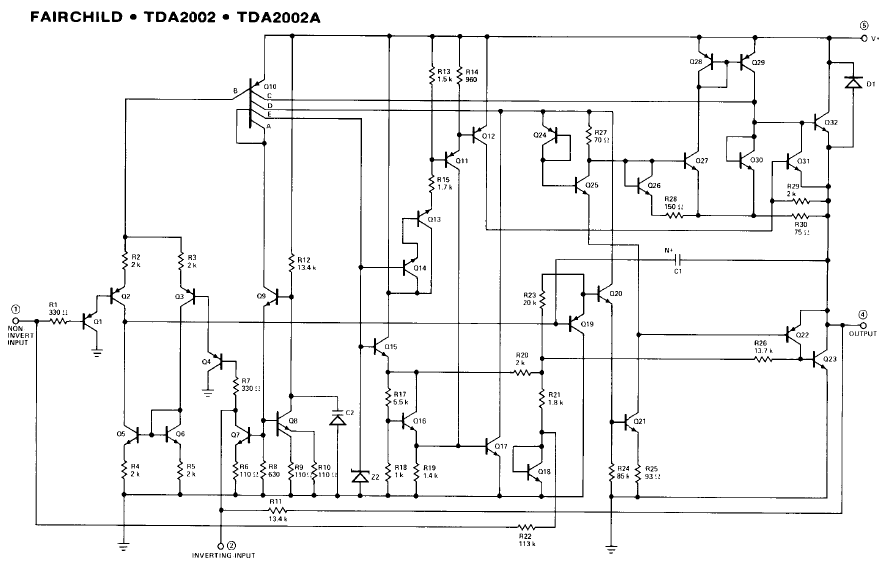

Hi Dan,
Speaker cones are supposed to swing forward and rearward. Your transistor drives it in only one direction with the other direction missing. It will have severe distortion. Real amplifiers have a transistor like yours to pull the speaker in the positive direction plus a PNP transistor to push it negative.
Your transistor doesn't have any voltage gain. The speaker's output level will be very low when the transistor is driven by the 100mV signal from a tuner, tape deck, CD player or MP3 player.
The minimum number of parts for a speaker amplifier is 3 transistors, a few resistors and a couple of capacitors. The 3rd transistor provides voltage gain.
I would show an amp like that to you but it sounds like crap because it has such a few number of parts.
You could make a pretty good, cheap amp with a power amplifier IC. They use about 30 transistors but cost the same as two.
That's a weird transistor, isn't it?
It's a multiple-collector dual-base thingy that can't be purchased anywhere. All of its collectors have identical currents or something like that. When they make it, the collector currents can be a multiple of the others if the area of the collector on the chip is different (or something like that). :lol: :lol:

High performance, excellent spec Single ended Pure Class-A amplifier, Flat response DC-5MHz.
The TDA2002 amp was class-AB and its response started dropping at 15kHz.

Plenty of power amp designs here;
Most of the time, an IC solution is most practical. For some higher power situations though, or more specialised equiptment, discrete is the way to go.
