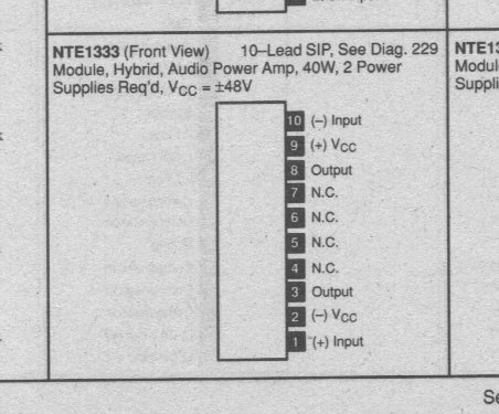

for a pioneer sx680 receiver anyone knows where i can find one or cross reference one. thanks :?:
A quick google finds plenty of hits, here's one you may find helpful as it gives information on the chip and others.
However, be aware that many of these old chips have been obselete for years, and there were never any replacements for them (I've just condemned a Sony Legato amp for that reason!). One reason I wouldn't consider buying an amp which uses them!.
Does this resemble your device? It is listed as replacement for STK0030 and STK0040.

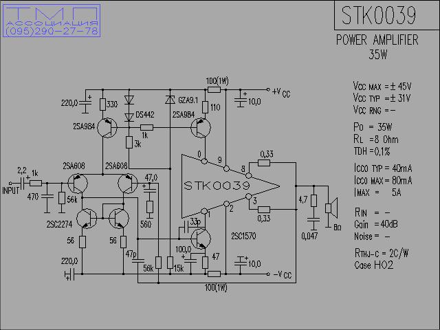

As a replacement for a STK0039 you need a NTE1282
Stk0039's are also still available on the net (search a little)
