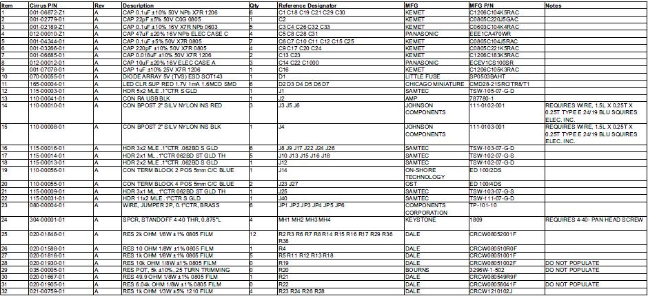

Hey guys.
Thank you very much, you have no idea how much you helped me out on this.
I wanted please to make sure something about sizes and power rating of components.
In the datasheet of an IC (CS5463) i use, there was its recommended layout and a table which contains the recommended components (size, power rating, tolerance, etc.)
This IC receives 5V and 3.3V in order to function.
I wonder, why did they recommend on such large and high power-rated resistors?
Most of the resistors in the table are 1/8W or 1/3W power-rated, but since their resistances are in 1kΩ (order of magnitude), than their power consumptions are not larger than
(5V)² / kΩ = 25mW. (1/8W is 5 times larger than that).
The 1/8th Watt resistors are 0805 size. It seems to be the size that has been standardised on for that design. There is hardly any cost advantage in going to smaller resistors, and they become more difficult to handle.
We pay about 0.15 cents for an 0805 resistor.
It is also much easier to assemble stuff and obtain all the components if it has lots of the same component. It certainly isn't worth changing resistor type just because one resistor dissipates a bit less power, unless size is really critical.
There is likely to be some reason that four of the 1k resistors are 1210 size. It could be power rating, voltage rating, or they could be larger to be easier to change by hand or to allow more tracks underneath them on that side of the circuit board. The design also calls for 0805 1k resistors, so those would have been used if they could have been.

The CS5463 (the bill of materials is actually for the CDB5463U development board) (please make it easier to find next time :mad:) is a power monitor and is not strictly 3.3V-5V. :p
You neglected to observe that the resistors in question are used to attenuate the AC mains voltages to levels that the CS5463 chip can tolerate.
:rolleyes: Therefore several of the resistors receive much more than 5V. :eek: They must be 1206 sometimes to have a 1/3W power rating, and other times to have clearance for the voltage.
