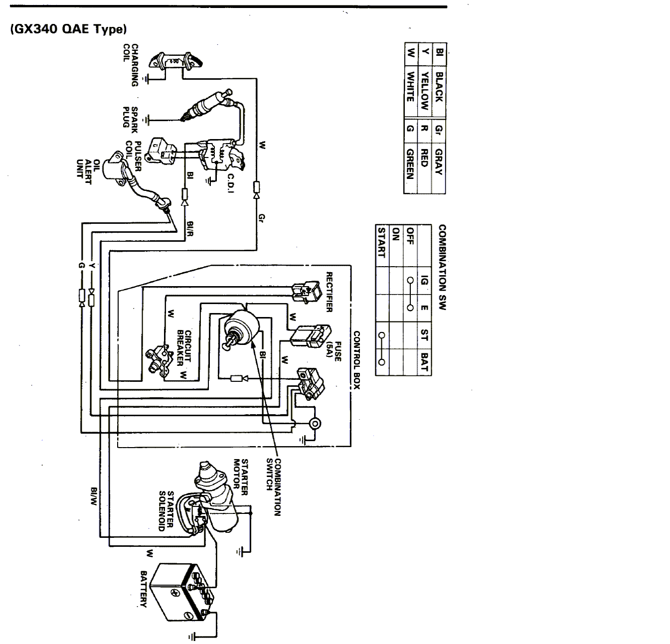

Hey guys, i want to make up a power converter from AC -> DC.
I want to use this on a go kart, is there any way to use a second coil generator, the same as the ignition coil but in a different location to set up a generator/charger?.
The 2nd coil would be separate from the ignition and it would not take any power from the spark. I know some mechanical energy will be lost since the motor will be slowed a little. However i will be using a smaller coil than the spark to help the problem.
The motor coil for the spark gets about 500V at Ac, i would want to convert that into 12V DC to power the karts lighting, and to charge the batteries during the day.
Any help would be appreciated.
Thank you.
I see this done on small engines all the time. They have a charging coil as well as a spark coil. The Charging coil can be purchased thru your local small engine shop. Just make sure you get the larger Amp coil. They usually make a 3 amp and an 18 amp. You also need to purchase a voltage regulator that goes to that coil.
