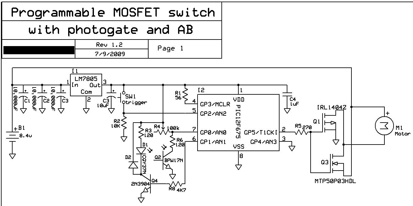

Alright, so I've been working on I guess what you could call an advanced solid state switch for a high current motor. The input switch allows for a user interface and the photogate allows for the microcontroller to monitor the position of the motor. Because the motor needs to stop immediately once the microcontroller tells it to, I am trying something which I believe is called active braking (or AB).
Here's my problem.
the current p-type MOSFET's cost is just a little high for what it is intended to do in this case .
Does anyone know of a replacement p-type MOSFET that would work in this case and can handle atleast 30A (I've had measured current spikes as high as 20A from this thing)

Your PFET will be ON even when the output of the PIC is high because the PIC will only output 5V when high. You MOSFET supply voltage is 8.4V leaving 3.4V on the gate when the PFET is supposed to be OFF. BTW, you've mixed up the symbols for the NFET and PFET.
Use a gate driver IC so you can use two NFETs and isolate the logic supply from the motor supply properly.
Because this thing isn't mean't for high-speed switching (it will be the control board within an Airsoft AEG) and the motor will really only be on in one direction, could an optocoupler and corresponding pull down resistor be put in place to isolate the mosfet's from the PIC?
Sorry, I'm just having a hard time understanding what the driver IC actually does.
The FET driver IC would allow you to use 2 NFETs instead of a PFET and an NFET. It can also provides a higher gate drive voltage for the FETs. It also provides a delay so that both FETs don't conduct during switch over.
Did you get what I meant by, "Your PFET will be ON even when the output of the PIC is high because the PIC will only output 5V when high."?

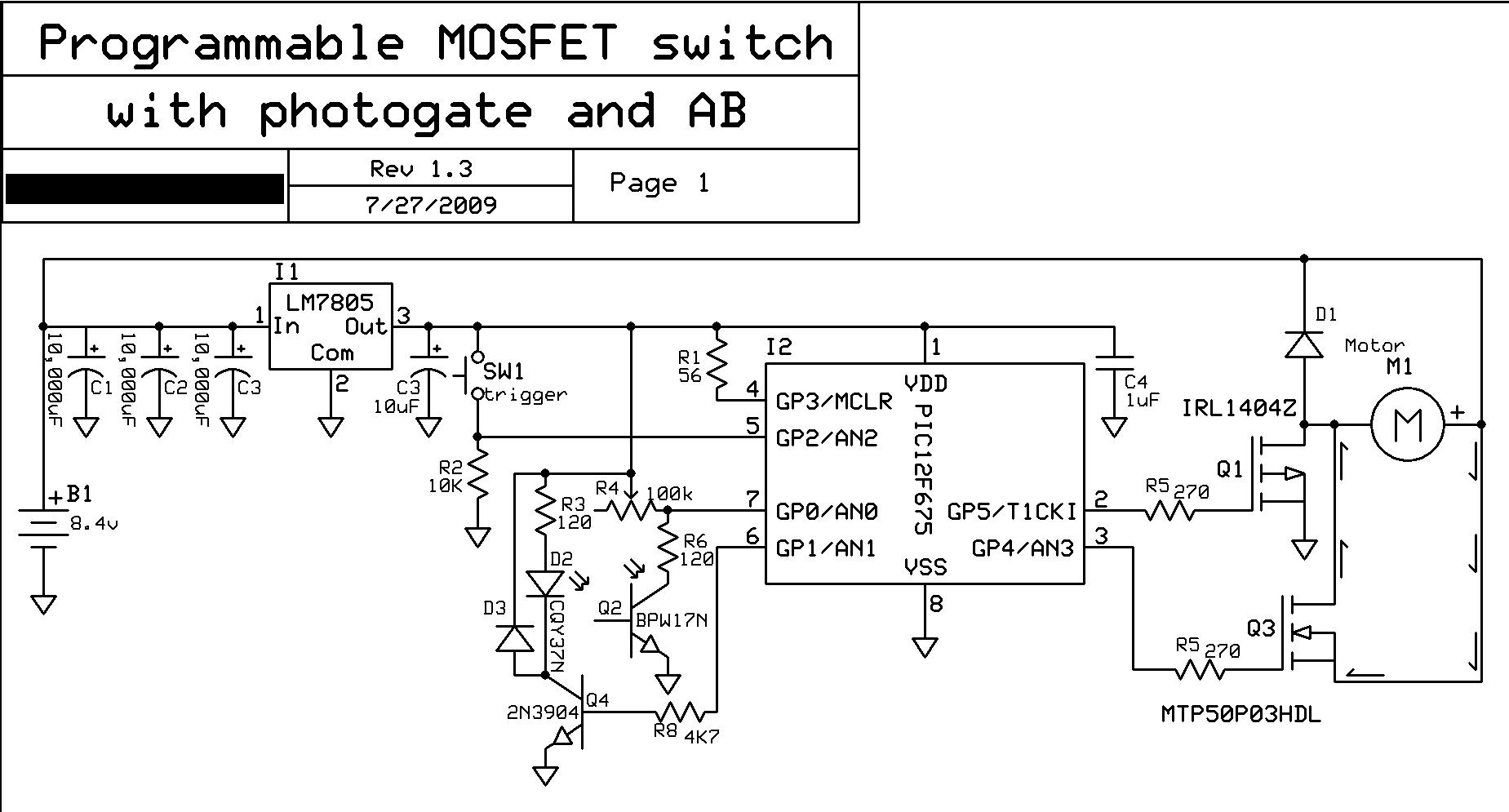

The p-channel Mosfet is a logic level mosfet similar to the IRL1404Z.
Instead of using the FET driver IC, would it be possible to run two IRL1404Z's directly from the PIC using the unused I/O with one controlling the motor and one becoming the motor's load as soon as the power to the motor has been cut?

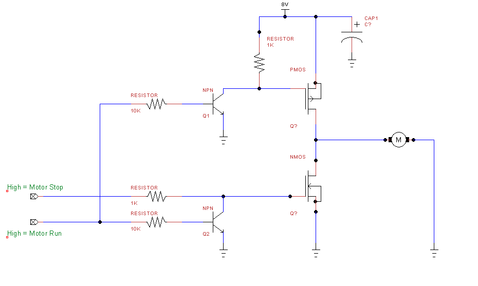

One way of doing it would be this way:
motor-png.31857
The the PIC needs to insert a short delay (Say 100uS) between Motor Run and Motor Stop. This is because there is a small switching delay in the circuitry where both FETs would be on if this delay wasn't present. Q2 takes care of the case where the PIC has gone nuts and attempted to both stop and run the motor at the same time. A high/low side driver chip would take care of all that. The above is a cheap, simple, low speed switching circuit.

I was hoping to use the N-channel for the motor to be powered because I know that the N-channel mosfets usually have a lower drain to source resistance that the P-channel.
would the attached circuit work as is or should I have an inverter between the output/MOSFET so that the gate is at 8.4v (similar to yours the collector of the NPN transistor would be connected to the 8.4v source through a 1k resistor.

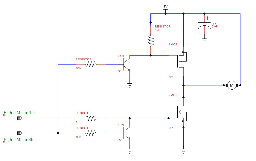

You'd need the extra NPN transistor for the same reason I gave before:
Your PFET will be ON even when the output of the PIC is high because the PIC will only output 5V when high. Your MOSFET supply voltage is 8.4V leaving 3.4V on the gate when the PFET is supposed to be OFF.
With my circuit, if you want the NFET to power the motor, you can simply connect the motor to the +8V rail instead of ground and swap the inputs like so:
motor-png.31906
