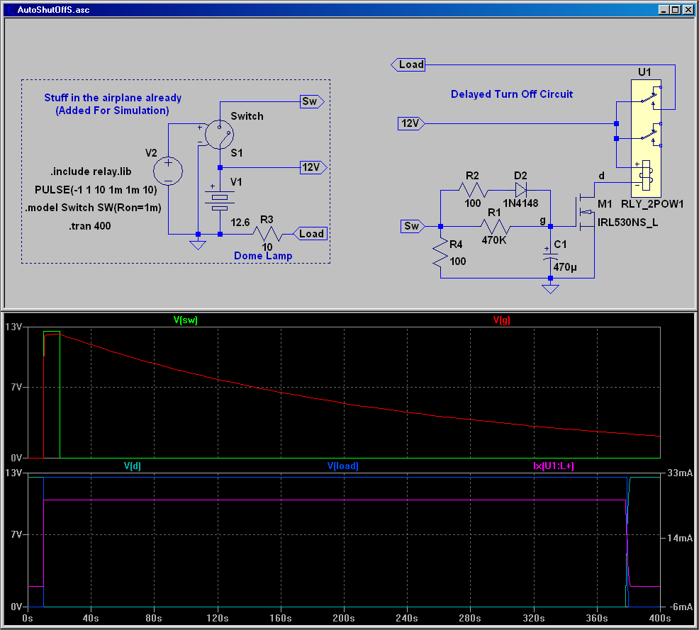

I am working on a circuit to turn off a 12 v relay about 5 or 6 minutes after the power source is removed. I adapted the attached circuit, using a 4700mf capacitor with about 27k resistance. This yields about 1 minute delay. Using an extra 2200mf capacitor in parallel with the larger one only results in about a 15 second increase in the delay time. I tried using more resistors, but raising the resistance by an extra 5K causes the circuit to stop functioning.
Anyone have any ideas about how to increase the delay to 5-6 minutes without increasing the complexity too much. I am a newbie without extensive electronic knowledge.

You can try replacing the transistor with a FET (e.g. 2n7002). A FET won't drain the power from your capacitor. The corresponding pins of the FET (BJT) are: gate (base), drain (collector) and source (emitter).
Replace the resistor with a wire.
Replace the 1n4004 diode with a 1n4148 in series with a 1k resistor. The 1n4148 has less leakage than the 1n4002, and the 1k resistor is just to limit the current while charging the capacitor.
Replace the capacitor with a 470uF cap in parallel with a 2.2M resistor. These values affect the time the FET is on.

This circuit is for the cabin light on my airplane. The light is independent of the master switch (equivalent of the iginition switch on a car). You want to be able to use the light of unloading bags, etc. but if you forget to turn it off, it will run the battery down.
So I set up the circuit with the master switch feeding the left side on the circuit, but with constant power to the relay coil. So when the master switch is turned off, the capacitor charge feeds the transistor until it bleeds down. My problem is getting that bleed down time long enough.

If you're having trouble finding a FET, you can just use your original circuit with an extra NPN transistor set up a darlington pair (as per image below). These two transistors replace the single transistor. The green B, C & E connect to wherever the original transistor's B, C & E were connected.
If the storage cap is 220uF and the base resistor is 1M, the on time should be somewhere around 7-10 minutes.

Here is a circuit similar to one I am using for another application. The simulation shows a delay of ~360s (6min).
The problem is that if I installed it in my Cessna, I could still run the battery dead because the switch is a slide switch. If the switch gets left in the on position, it will kill the battery. You would have to replace the switch with a momentary spring-return push-button to eliminate the dead battery possibility.
Resistor R4 is there to provide some significant current to keep the switch contacts clean, and provides the discharge path for the timing network. R2 limits the initial inrush current. The delay time is created by C1 discharging to the threshold voltage of M1 (~3V) from one diode drop below the battery voltage, about 2(R1+R4)C1.
Note the traces in the simulation. Green V(sw) shows when the switch is closed. Red V(g) shows M1's gate voltage. Lt. Blue V(d) is M1's drain. Dk. Blue V(load) is the voltage at the dome lamp. Purple is the current through the relay coil.
Note that you do not need to build the stuff in the dashed box. V2 is the human flipping the switch S1. R3 is the existing dome lamp(s). V1 is the battery.
M1 is almost any modern NFet which has an Vds >30V (50V if your airplane is 28V) and an Ron<250mΩ.
btw, for the ones who will notice, there is no, nor does there need to be, a snubber diode across the relay coil.

I just went and grabbed several 330uF to 1000uF 16V or 25V Aluminum electrolytics from my parts storage. I charged them to 12V, disconnected the power supply, and periodically checked the terminal voltage with my DMM (input Z=10megΩ). With the DMM disconnected, the time of self-discharge down to 3V exceeds 10min. If the meter is left connected, the discharge time decreases noticeably. Conclusion: the leakage current is smaller than would be caused by 10megΩ.
This says that in a circuit where the discharge resistance is 470KΩ, the leakage current is small compared to the current through the timing resistor.

I agree that capacitors with enough capacitance to drain slow enough are easy. My problem is the transistor/FET/Darlington pair to use for powering the relay coil and the resistance to use. My original set up worked OK except for the timing. I theorized (with admittedly little knowledge) that raising the resistance high enough to slow down draining the capacitor resulted in not enough voltage getting through to power the transistor. Is this theory likely. I have plenty to learn.
Don
In the orginal circuit, the primary discharge path is via the base current of the NPN transistor (worse if it is not a Darlington). Using the NFET, the gate current is just the gate leakage (100nA), which is ~10000 times smaller than the base current of the Darlington. The discharge of the timing capacitor is the electrolytic's self-leakage in parallel with the current through the 470KΩ timing resistor.
Don, your idea is close; the problem is that there is not enough current provided to the transistor to turn it on sufficiently. Using the darlington pair in place of the transistor allows you to use a base current 100 or more times smaller, and still operate the relay. It also requires the least modification to your existing/original circuit.
