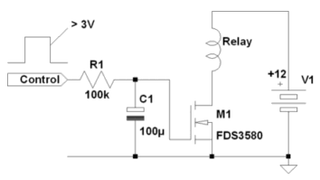

I have 12v , 200 ohms relay... it need 12v and 60 ma current to work properly...
This will give ~ 4sec delay, adjustable by varying R1 and/or C1.
Edit: A reverse-biased diode should be connected across the relay coil to protect the FET from the back-emf generated when the FET switches off.

Thanks alec... it worked...
Glad it did. But note the edit in post #9 if you want it to continue working!
