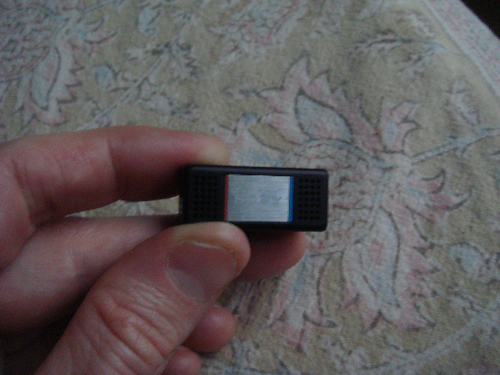

I could post a picture of it on here if that would help. Can you put images directly onto the forum or do they have to be on another site with a link posted here?

Here you go. I'm sorry about the image quality, but it's getting a bit dark here in gay paree.
I presume the 2 bands on the jack signify that it is stereo, and not balanced as I had presumed?

OK: Back to square 1:
-What is the make/model of the mic? All modern commercial mics accept 9 to 50V phantom power, if wired correctly
-The pix you provided seem to be a gadget, for a video camera, cheap electrets plug into
-To mount a mic on an acoustical instrument may change the tonal quality of the instrument or not pick it up correctly
-As most acoustical guitars use metal strings maybe you should investigate an electro-magnetic pu

An old or a professional microphone is a "condenser" mic. It needs a high polarizing voltage.
Modern, inexpensive "electret" mics also have excellent performance but have the high polarizing voltage built into the electret material. They have a Jfet inside to reduce the output impedance. The Jfet needs 0.5mA at 1V to 6V for power.
The Sony stereo mic probably has two electret mics inside. They are powered from the little battery.

The power supply for an ordinary electret mic is a 9V battery with perhaps a 47uF capacitor across it and a 10k current-limiting resistor. That's all that is needed.
