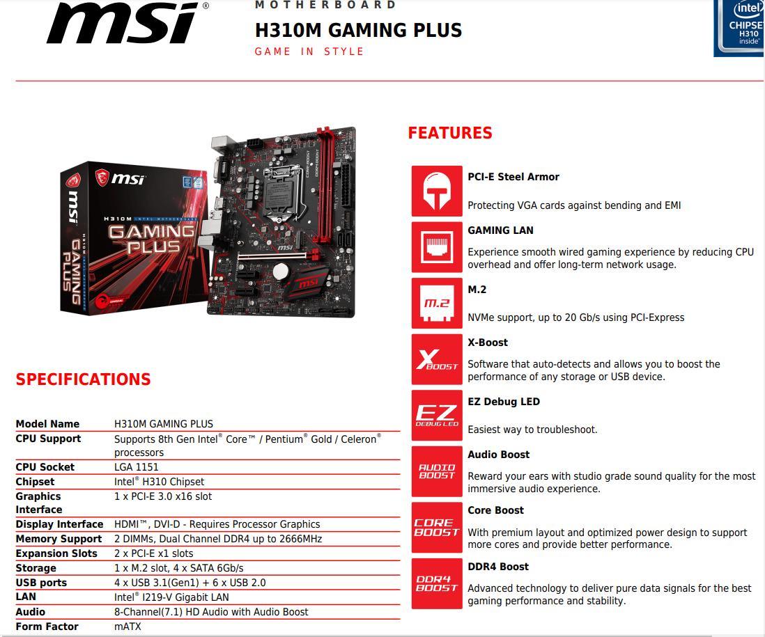

Anyone knowledgeable in configuring correctly a product of power related stuffs, so can point a decent one?
What'd be suitable PSU for ~ 65 TDP CPU set in motherboard MSI H310m:
Find the PDF spec sheets for your motherboard and video card. Look for the watts used and add them together and add 20 watts for the rest of your setup.
My general rule of thumb is:
Max CPU power + max GPU power + 100W for the motherboard chipset + 10W per attached drive or device.
The round the result up to the next standard PSU rating.
Look for an "80+" rated type, as they are more efficient that non rated ones, they take less input power (so cheaper to run) for the same load rating, and produce less waste heat.
