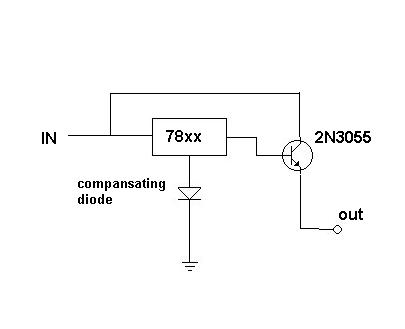

use a transistor as shown with the regulator to get more amp as you want.
An emitter-follower at the output of a voltage regulator ruins the voltage regulation.
But I guess the fans will not care.

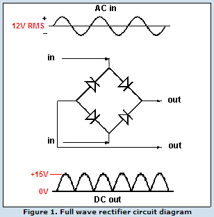

i was thinking of using a 12v 50va transformer and put it into a bridge rectifier will it need smoothing out with any capacitors?
hi
When you rectify a transformer with a bridge rectifier then the output is humps of voltage at double the mains frequency. The peak voltage is 1.414 (the root of 2) times the RMS voltage of the AC. The voltage swings from 0V to +17V minus about 2V for the rectifiers for a 12V transformer. If you add a large enough filter capacitor then you will have +15V that is fairly smooth.
