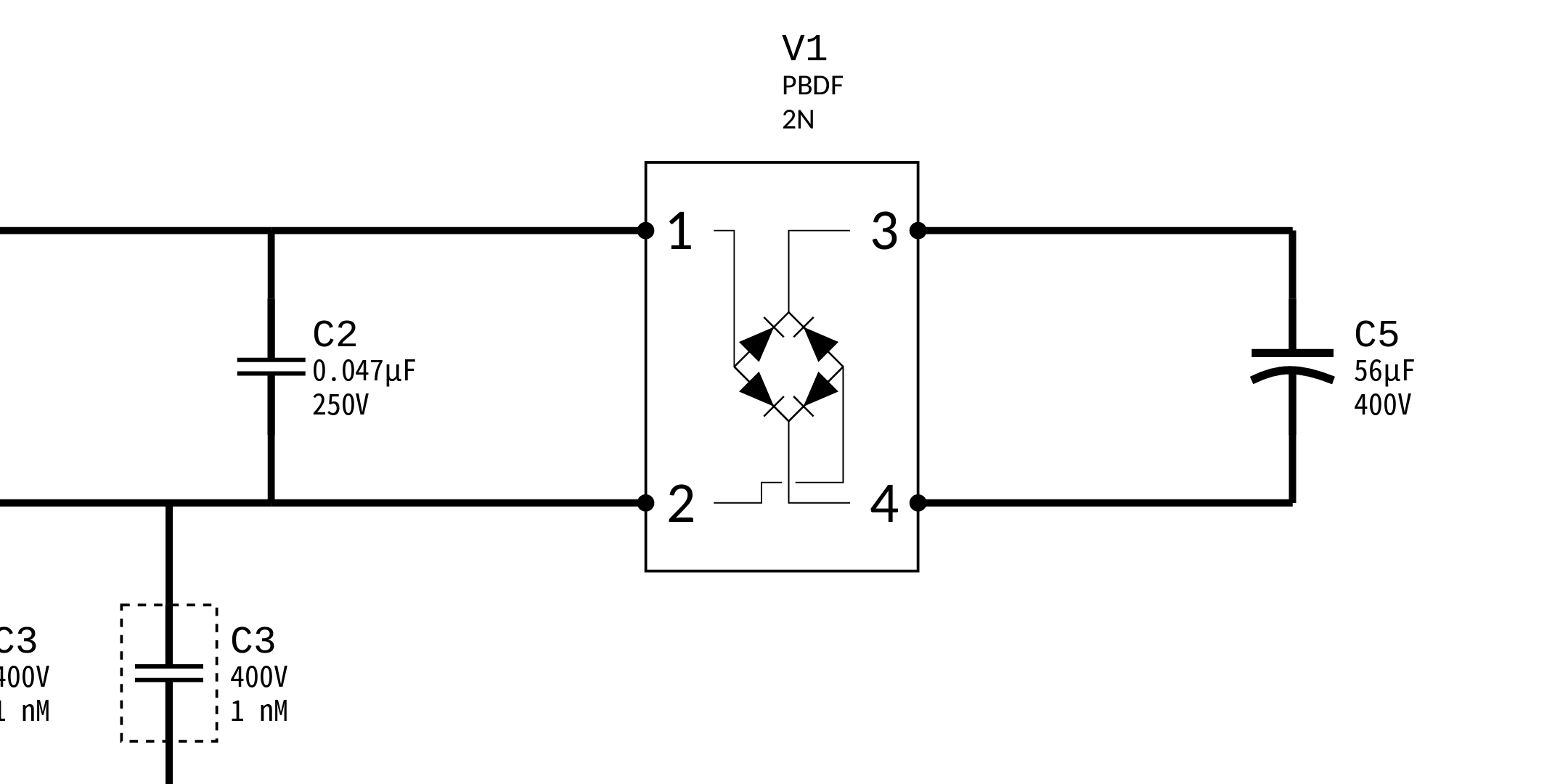

Due to a ton of time thie easter, I've spend some time on this PCB board and draw up what the schematic should be. I put it up here if someone wish to discuss this design and my comments on it.
It takes 110V input, and use a UC2844N. What is spechial about this is the use of a BC557 PNP transistor in the feedback loop, I have some struggle to figure out about this because the datasheet for UC2844N doesn't include a similar use of a bjt transistor (ok, TI has an example design using a NPN transistor).
Thing is - those power supplies tend to stop working after approx 20 years in use, and the goal here is to find what component that is likely to fail at first. Maybe an electrolyte capacitor. The design doesn't seems to be designed to use be as power efficient as possible.
I do suspect those board may not be properly designed to handle when input voltage slowly decreases below ~85V (110V battery not being charged).
Components sharing same hetsink:
Primary: V6 and V22 (both mosfet's)
Secondary: A3 and V18, A2 and A4
I've not tried to put input voltage so I don't know what component are failing. I'm considering if I'd wait until I have a 110V DC source or just pickout some caps and use my ESR meter to test them.

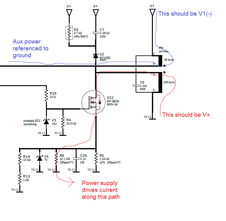

The schematics have a few mistakes which makes reading them difficult. The +12 and +24 V output labels are swapped over. The main transformer power inputs V+ and V- are the wrong way round. It isn't clear where wires cross and where they join. It is easier to read if there are no points where 4 wires join. They can be staggered to have two T-junctions. For instance, I think that R23 and R24 are in parallel, but I'm not sure. The voltage feedback seems to have been forgotten.
I suggest that you look at R7 and R10, and at R9 and R12. I had similar resistors in series fail. It is outlined in this thread:- https://www.electro-tech-online.com/threads/failed-resistors.158347/
Thanks. That's obvious but I didn't spotted it first.

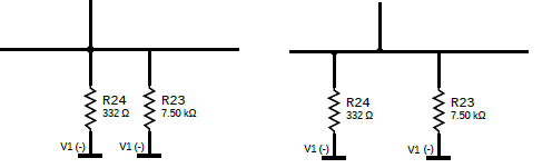

Ok, I can "put a dot" where all intersections are to make it more readable.

The transformer inputs are wrong, I think. It's not about the ease of reading.
On the ease of reading, the schematic should be arranged so that dots are never needed.
If I've understood the left drawing correctly, the wire coming down to R24 joins the horizontal one, but I'm not sure. In the right diagram, I've moved the resistor to so that the dot isn't needed.

The bridge rectifier is not exactly a bridge rectifier...
Some of those diodes are bass ackwards.
Thank you. I oversaw some thing, but when I re-checked it turns out you've right. Initially I didn't got the diode name because the printing was facing down toward the pcb, so first when I got another similar pcb I was able to put the name on, but I totally forgot to see the error.
Thank you (I did learn new english phrases on dumb stuff, how cool is that?)
