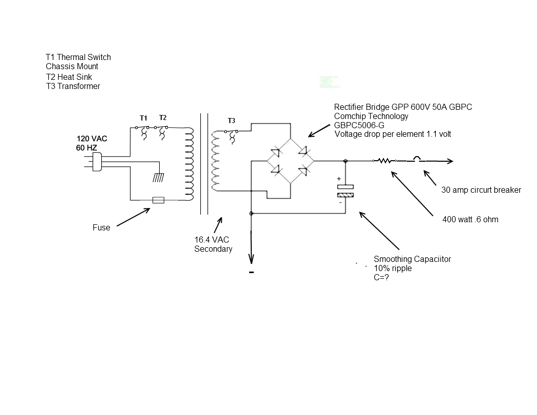

I have posted another thread on a very similar subject but I’m afraid it became too twisted. I asked too many questions and started out with some wrong information. I’m sure I confused everyone.
So I will make this brief and to the point.
Will the attached circuit work?
I need an out put of 15 + volts at 25 amps
Can anyone assist me with these calculations?
What would my final output voltage be?
What should the value for the capacitor be to achieve 10 % ripple?

Well, again, we need more information.
How much current is this expected to deliver? (I can see a 30-amp circuit breaker: does that mean you want it to be able to deliver 25 amps continuously? 30 amps peak?)
Can't size the filter capacitor until we know that; then you can calculate it to get no more than 10% ripple.
And why do you have that resistor in there?
Yes, it'll work: at least, it looks as if it won't blow up when you plug it in, and it'll probably deliver DC to the load. But as to whether it's suitable for your application, still can't really tell.
Why do you show a "heat sink" as a component in series with the primary? Generally speaking, heat sinks aren't shown as parts of schematics (possibly as notes). What is that exactly--another thermal fuse?
25 amps
The breaker is a fail safe at 30 amps
The resistor is in series with the secondary winding to control the current output to 25 amps
T-1, T-2 and T-3 are thermal switches (heat-sink, chassis and transformer) are their location.
It looks like you're going to need a mighty big capacitor there.
Quick formula from my electronics textbook for minimum capacitance, given allowable ripple and load resistance:
Cmin = 0.24/(r * Rl)
where r is the ripple factor. (%).
Since you're running 15V @ 25A, your load resistance is 0.6 ohms.
Plugging this in gives a result of ... 4 farads. As in farads, not microfarads.

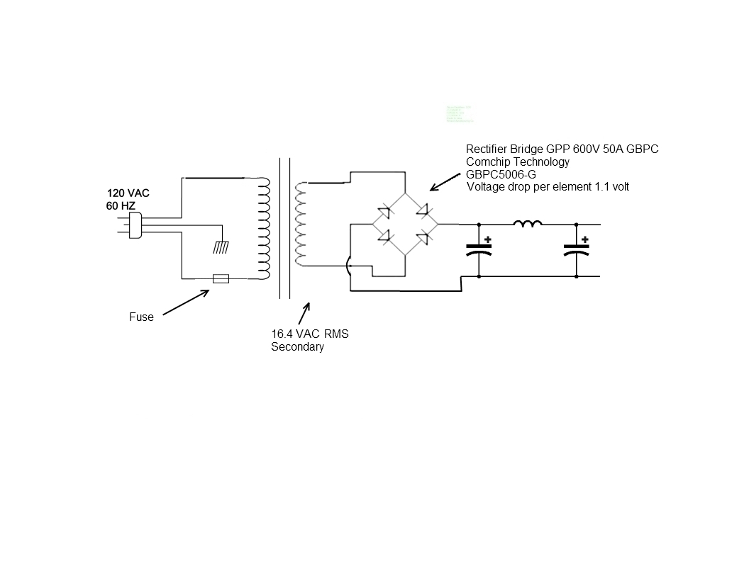

You may like to put an inductor in place of the 0R6 resistor. This will reduce your capacitance considerably - by using a capacitor-inut pi filter. The only thing to do is buy the largest inductor possible or wind one yourself and start with 10,000u x 2 on the input and 10,000u x 2 on the output. Load the power supply and view the waveform on a CRO. You can also buy 100,000u but they are much more expensive.
The inductor gives you the maximum possibilities as you have about 5v - 6v to play with.
If I've understood the requirements correctly then unfortunately the circuit won't give the desired output. The peak no-load voltage on the cap is 16.4 * 1.414 - 2.2 = 21V. If the load draws 25A then the voltage drop across the 0.6 ohm resistor is 0.6 * 25 = 15V. So the voltage across the load is never more than 21 - 15 = 6V; not the required 15V. Moreover, no allowance has been made for the transformer regulation. The voltage drop due to the transformer winding resistance will result in an even lower load voltage.
IMHO for the required output it would be much cheaper and more efficient to use an SMPS rather than this circuit.

Here's your capacitor-input pi filter:
In case you were wondering, it's called that because it looks like the Greek letter pi (lowercase).
Component values TBD.

Is this what you had in mind (see attachment)
Will I still need a resistor in series with the transformer's secondary to control the current output?

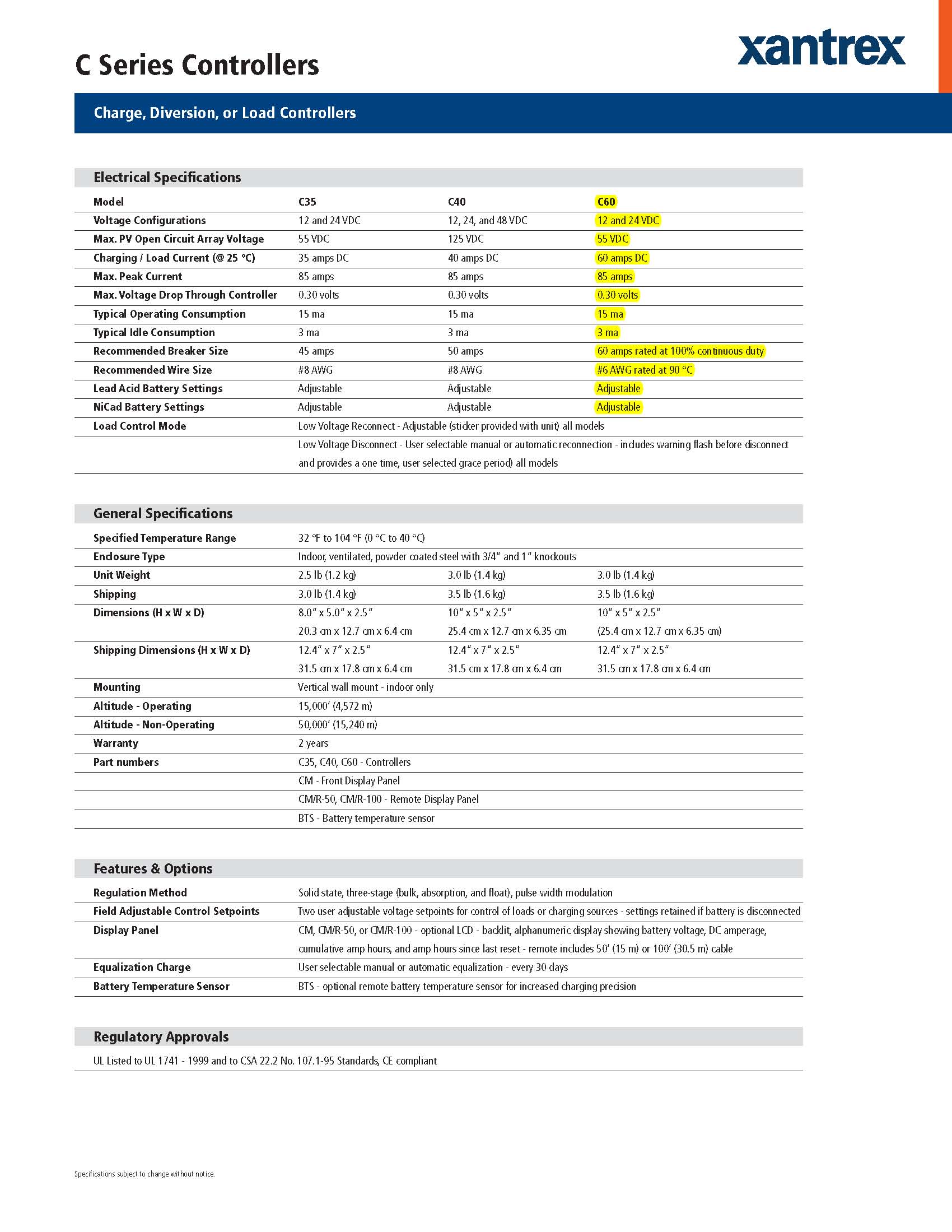

colin55 ronv Attached is the data sheet for the controller. I have the entire manual but it does not go into any more detail about the internal working of the unit. I doubt that Xantrex will part with a schematic.

That's it.
If you're going to use a charge controller then you don't have to worry about limiting the current; the controller should do that. (The inductor will limit the current somewhat, as it has a little resistance.)
The output from the 4 diodes will become smoothed DC once the controller is connected and delivering current to the battery.
You don't need any smoothing or filtering or current-limiting components.
