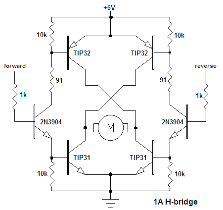

Hello,
I'm having a very strange thing going on, when I connect my H bridge circuit to +9
power supply the voltage of the power supply drops to 5 v, I don't know what is the problem
that is the H bridge circuit
I connect the VDC to +9 v power supply and the 4 inputs to the H bridge connected to the MCU which is connected o another power supply 5 v
and the two power supply grounds are connected
I don't know what happens to the voltage, why is it dropping, I tried to separate the two grounds, but still there is the problem
Can anyone help?
The input signal level for the PNP transistors must be the same as their emitters (the supply voltage) or the PNP transistors will never turn off and the battery will be shorted.
But your input signal is only 5V from the MCU and if the battery is 9V then the signal should also be 9V.
You could add an NPN transistor to drive each PNP transistor to fix it.

Is this circuit good to drive the PNP?
You need resistors in the base of each 2N2907 otherwise there will be very high current going through the bases of both bridge transistors that are on, which will likely blow at least one of the transistors.
My circuit uses power transistors and low value base resistors for 1A output. It has all the resistors that are missing on the circuit you found:
