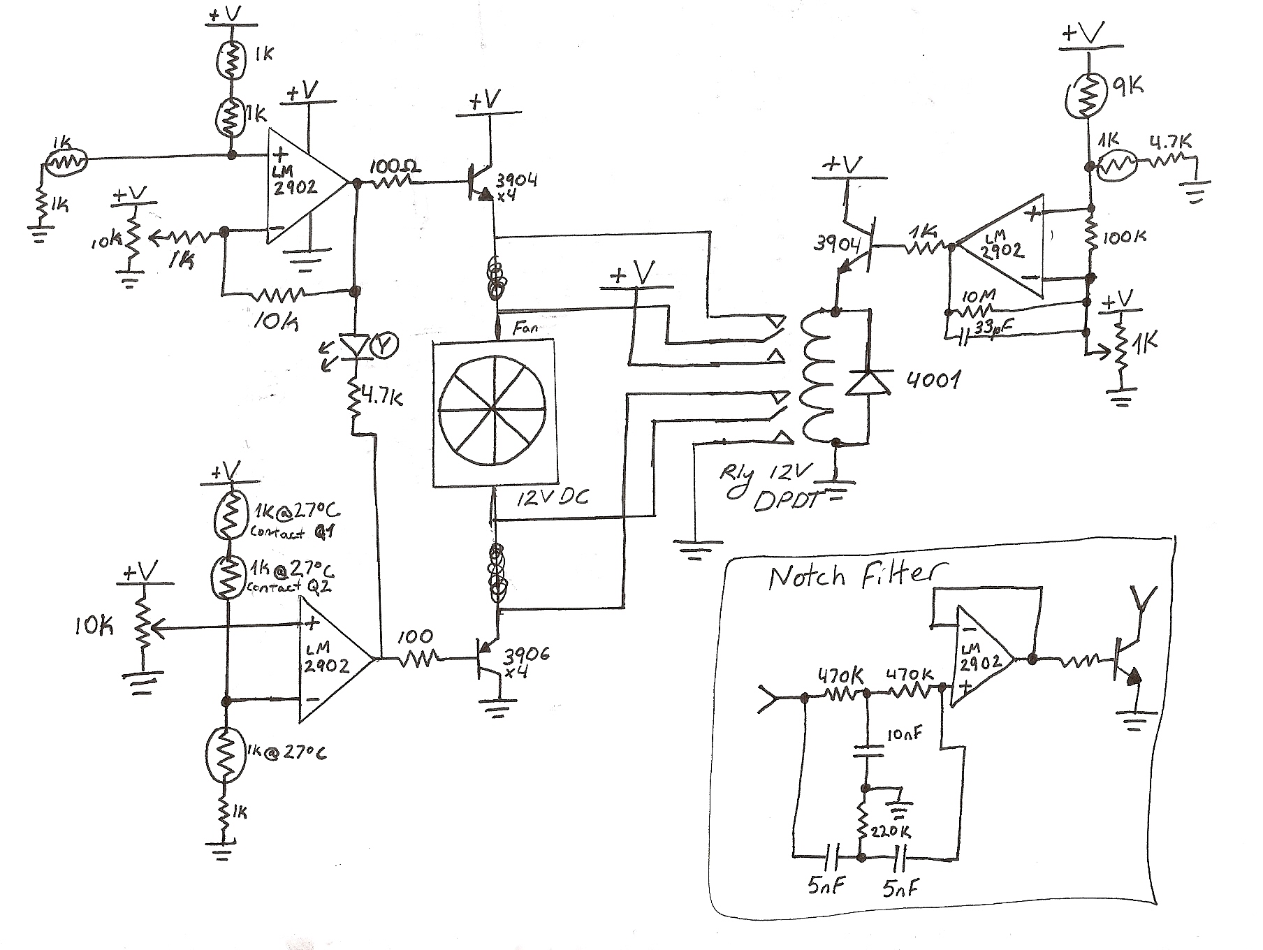

For the circuit that cools the power supply I am using 2 op-amps to control the fan. Then I added a 3rd op-amp to drive a relay to power the fan if the temp starts to become dangerous. I figured that I'd just use a quad op-amp instead of 2 or 3 separate ones. But what to do with the last op-amp?...

The reason that I have a fan installed is because some of the parts are heating up to 100 degrees or more (Farrenhight). The space is limited inside of the box so the fan is needed so that a large heat sink is not. And the fan is also just a way to show off to the people that don't know about electronics.
But the fan has caused some problems for me. The 3rd op-amp is configured as a comparitor and it triggers a relay (to over come the voltage drop of the other op-amps and transistors that control the fan). The op-amp trips at 140 F to cool the transistor that makes the most heat (Q2). I can't get it to stay on untill it colls to 120 F before shutting off (the thermistor is on the opposite side of the heat sink that the fan is cooling). Any suggestions on how I could get the op-amp to do what I want?

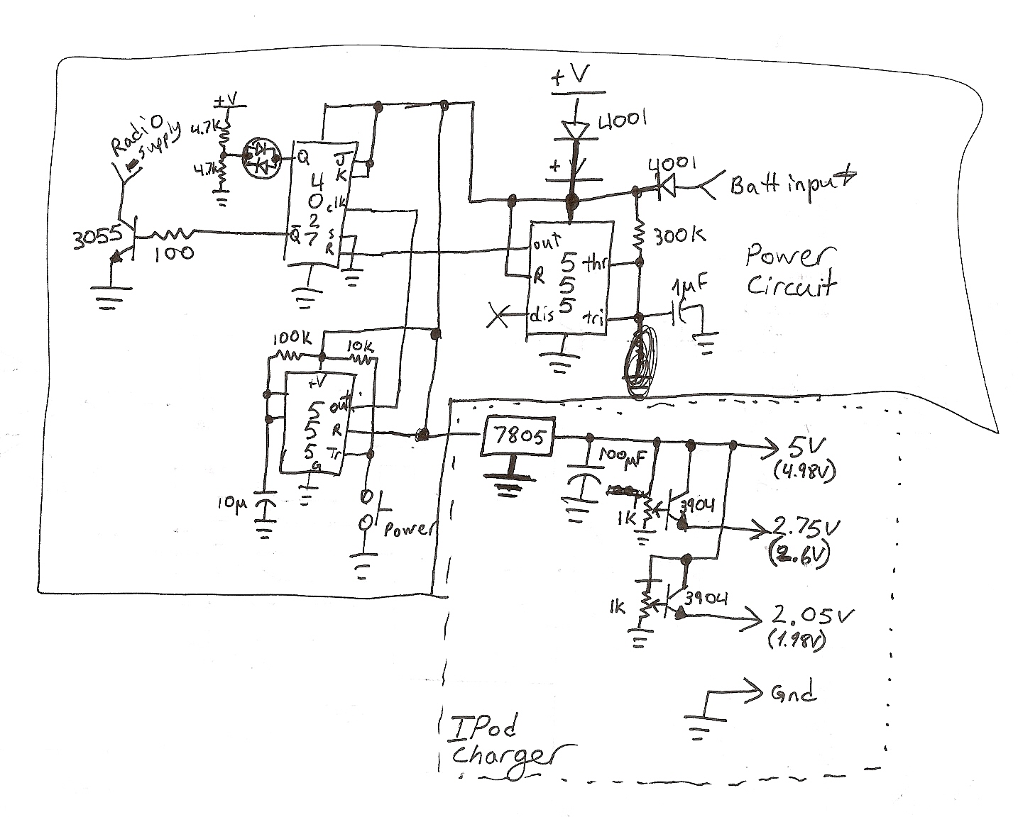

Now it seems that I need the filter, I had the radio pluged into the new power supply last night for the first time. The radio cusmed a lot of current from the supply, however it still worked properly. Untill I tried to attach the iPod to charge, then I started to get a hum comming from the amp. When the iPod was removed then the hum went away.

I can't seem to figure out why the iPod charger would cause the amp to hum... The only thing that they have in common is the input from the battery, but when I was testing, the battery was not being used.
I also thing that I solved the problem of the "dead zone" in the op-amp. Please tell me if I did this correcly, but I added a 100k resistor between the inverting and the non-inverting input.

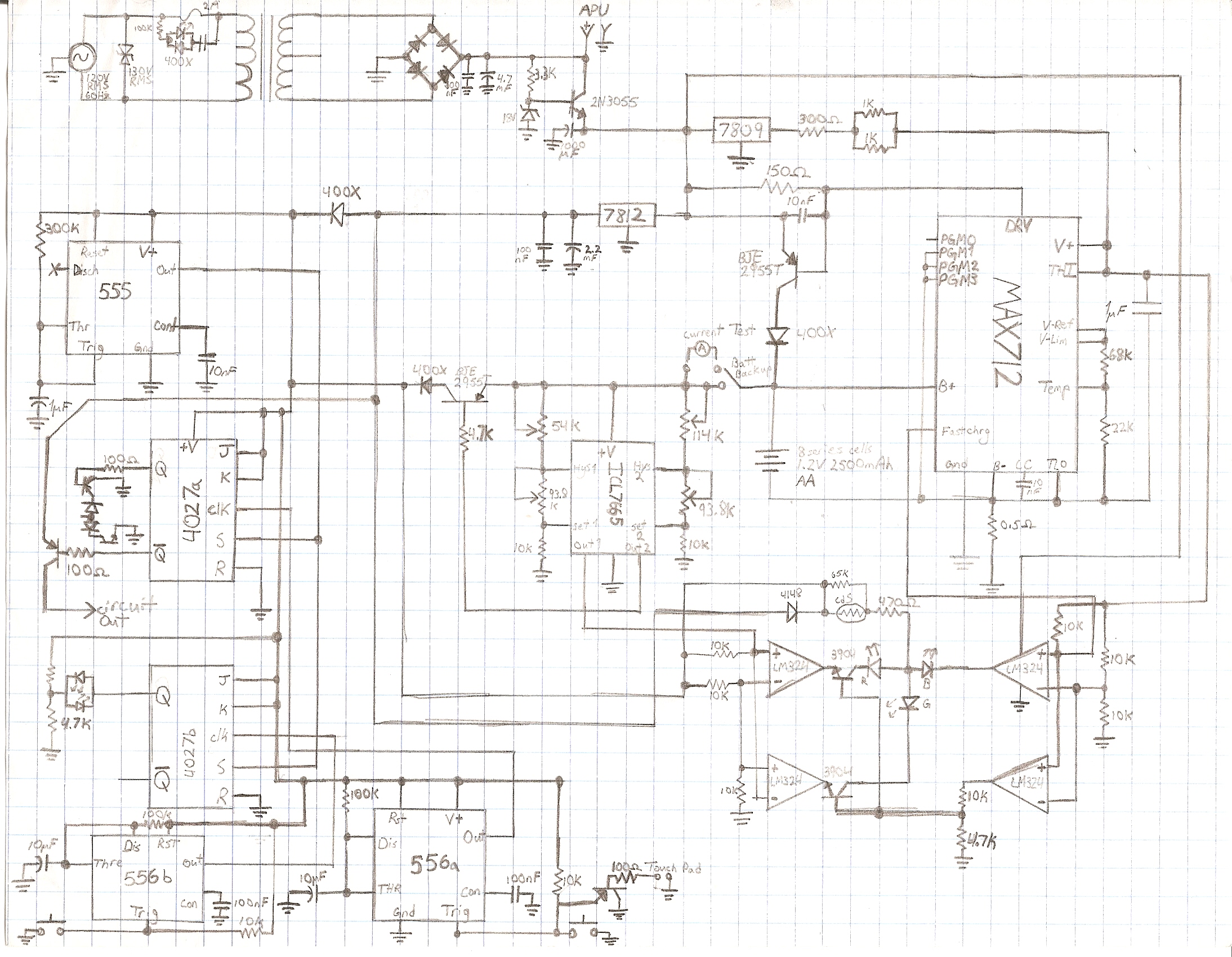

For audioguru's satisfaction, I have provided the schematics of the circuit. Image 1 is of the power supply as a whole (the fan is not included). The second image is of just the fan control circuit (I also sketched the notch filter into the corner, just ignore that). The third pic is of the general concept of the power supply. (This is the circuit that I would like help with, it has the evil hum when the iPod is trying to charge and play at the same time but not if only one is trying to be done)
Just to answer your questions about the PNP transistor (Q2 which is getting hot) the voltage is 18V and the current is roughly 500mA, so it's dissipating 9W. That's well within the wattage rating of the MJE2955T. A larger heat sink will be added in the final circuit.
For Transistor; yes, the radio was made by Sanyo. I looked up the data sheet for the LA4108 and I got absolutely no help in how to rebuild the circuit, so I chose just to leave the amplifier and the radio receiver alone (they would most likely not work if I tried to rebuild the circuit). No, the upgrade of the radio will have an FM transmitter built into it so it can broad cast to a more power full radio [sinister laughing]. The radio already has an auxiliary jack built into it. But yes I intend to add a VU meter (and a lot of other things)
Sorry about not including the schematics in the previous post. I have uploaded them this time, but it would not upload them in the correct order (really weird).
The new order of the schematics are as follows:
1) Fan Control
2) The entire power supply (minus the fan control)
3) The part of the circuit that is causing some problems

The output voltage of your transformer is not labelled and the positive rectified and filtered voltage from the bridge recifier is also not labelled.
One 2N3055 transistor is short-circuiting the positive supply to the radio.
The transformers output voltage is 33V RMS, the voltage on the rectified end of the circuit (just calculated) is roughly 45.2V DC The 3055 is not shorting the radio, the collector is tied to the negative supply for the radio. However, I just replaced it with a 2955 on the positive supply because when the iPod was connected for charging, it was completing the circuit for the amp (I forgot the most important rule of electronics, all grounds are connected).
Guess what? Your transformer voltage is way too high which makes the heat.
33VAC has a peak of 46.7V which is dropped 2V by the full wave rectifiers to 44.7V.
But your Mickey Mouse discrete regulator has an output of only 17.3V so the series pass transistor dissipates (44.7V - 17.3V) x 0.5A= 13.7W because the transformer's voltage is way too high.
The Issue of heat with the 3055 transistor is under control, it's the heat with the 2955 responsible for charging the battery that is concerning me a little. I have a heat sink that is ready to be used on the 3055 and a much better heat sink ready for the 2955, but I would still like to have the relay activate the fan at 140*F and stay on until it drops to about 125*F.
