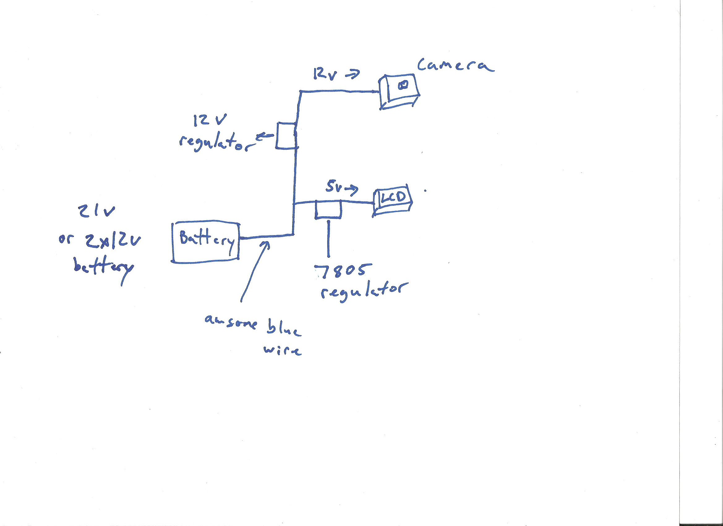

The camera needs a 12V regulated power supply. But 8 alkaline battery cells are not regulated and their voltage starts at 12V then slowly drops to 8V.
You will need 14 alkaline battery cells to make 21V when new which drops to 14V over their life and they feed a 12V regulator that has a huge heatsink. If the LCD needs 5V then you need a 5V regulator with another huge heatsink. The datasheet for the battery cells shows how long they will last.

Ok so here is what I have so far I think this is what I should do see attachment.
Do you think this would work?
It would work, but with major problems. Main one being the need for huge heat sinks on the voltage regulators, as has been previously pointed out.
Keep in mind that a linear voltage regulator works by shedding the excess voltage (the difference between the input and output voltages) as heat. Heat's gotta go somewhere, or it'll cook the regulator. Plus, you're wasting precious battery power heating things up.
I was thinking if I need 21v then could I just use 2 12v battery like this one?
https://www.jameco.com/webapp/wcs/stores/servlet/Product_10001_10001_318844_-1
If you're going to use a 12V SLA battery, I don't see why you can't run the camera directly from it (after all, it takes 12 volts), then use a 7805 regulator to provide the 5V supply.

Why not try it and see how it works? Look at it this way: you can put it together and see how it works, checking the 7805 to see how hot it gets. If it gets too hot to touch, then you either need a bigger heat sink, a bigger chip (i.e., a 5-volt regulator that can handle more than 1 amp), or both. In either case, you'll be out, what? about a buck.

So the safest bet would be to have 2 12v battery then not worry about anything then I I need more power by switching up a camera or adding some leds to it latter on then I will have enough power for everything
When you put more batteries in parallel, you increase the amount of current (amps) you can draw; this can put off the time where the battery voltage drops, but not forever.
The problem with using a 12-volt battery on a device that runs on 12 volts is that over time, the battery voltage will drop below 12 volts, as Audioguru pointed out. At some point, the voltage will be too low for the device (camera, whatever) to function properly. How low can you go? We don't really know; the only way to really find out is to try it. It probably won't damage the camera, but at some point, it will start exhibiting flaky behavior, or will stop working altogether.
Ideally, you would use a voltage source (battery) that's higher than the voltage you need by some significant amount (say, 14-15 volts), then regulate the voltage down to 12 volts. This will give you a longer run time before the battery voltage "sags" to an unusably low level.
