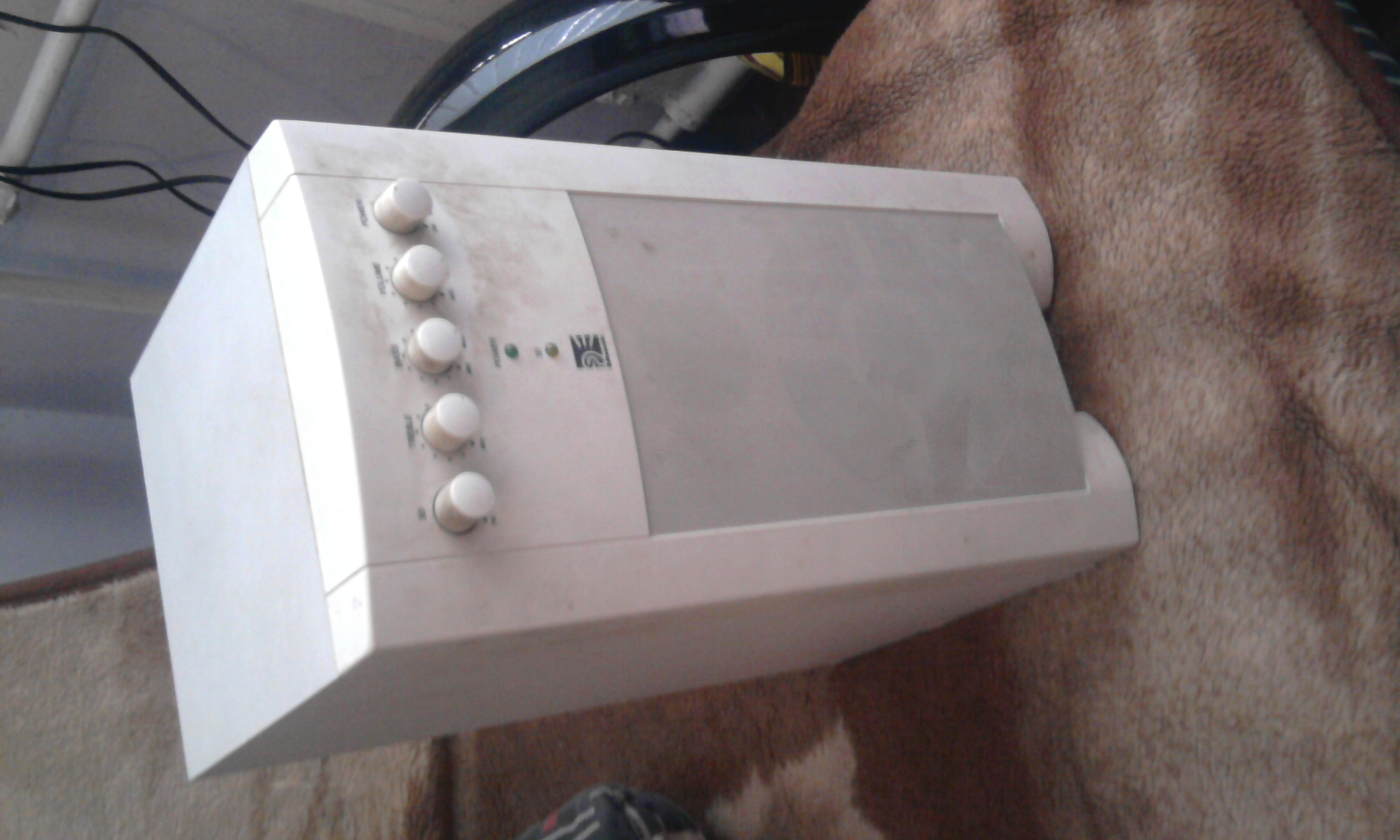

hehe, let's see...
I'll write down whatever i see cause it's very old and manufacturer is either unknown or "Edtasonic"
Ac 230v 50HZ
Driver: 5.25" Woofer 2.5" Fullrange
Input impedance: 8kΩ
Woofer frequency presponse: 30Hz~150Hz
Satellite frequency response: 150Hz~20KHz
T.H.D.AT 50Hz(1w Output): Woofer-<0.05%
T.H.D.AT 1KHz(1w output): Satelite-<0.1%
RMS. Output: Woofer-30w Satelite-5w per channel
(nothing else imporant is written on it.)
looks like typical computer speakers to me.... those THD figures are probably lies...... what you have here is a "system" that is probably 10 to 15 watts total, with 5 watt speakers, and the subwoofer driver might be rated at 10 watts. the power supply is most likely 12V DC, as that's common for computer speakers. you could probably get away with disconnecting the power transformer and connecting the battery in place of it. if you want to see how some of these manufacturers come up with their fictional power ratings, there's an article here: **broken link removed**

The power is rated in RMS Watts which are real Watts but the distortion is shown only at an output of 1W. The distortion is supposed to be shown at the rated output power.

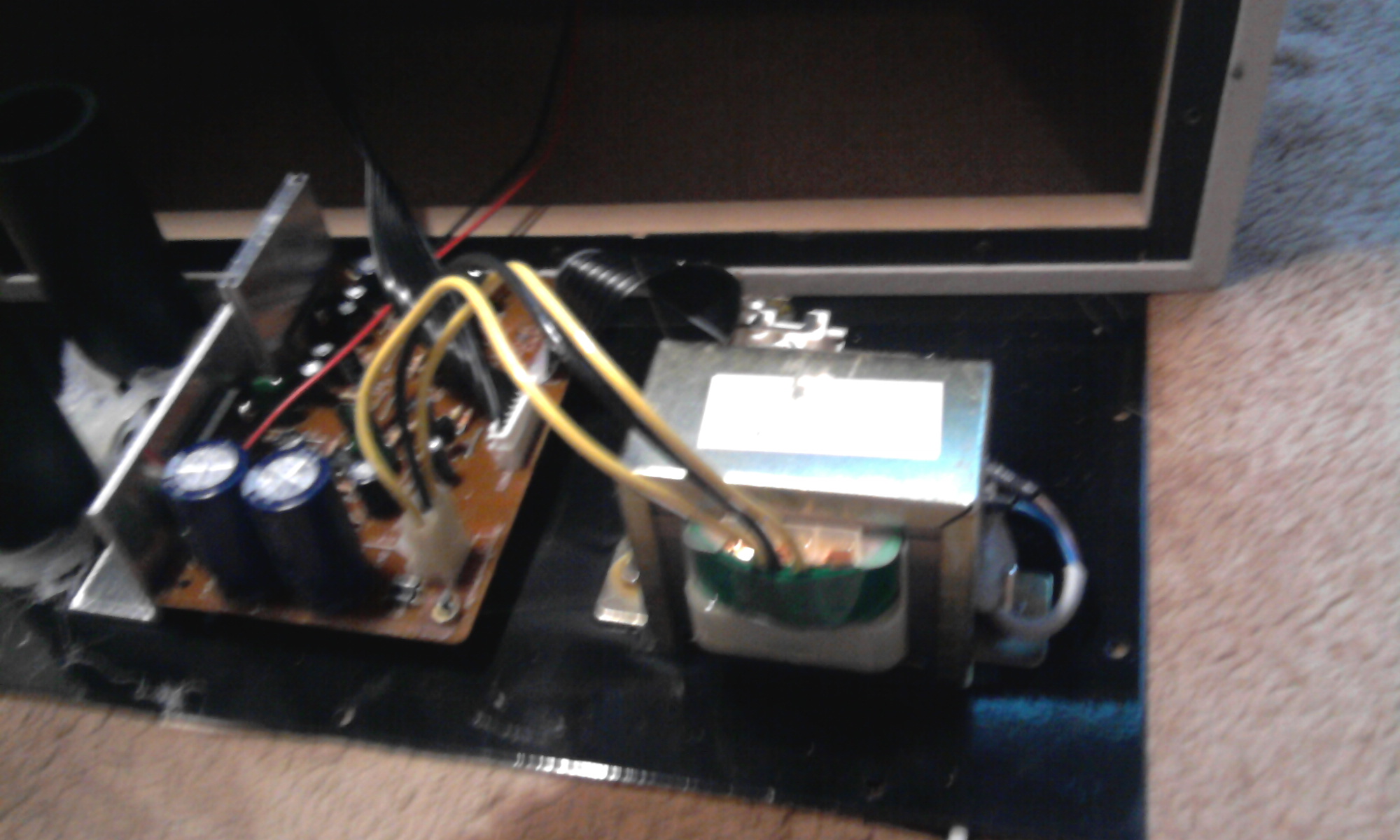

well if i would open that thing up, wouldn't i find some info on the parts inside?
this is what I found... and i take it that the object on the right hand is the main problem...
and this stuff is written on it:
I/P 230V 50Hz
O/P 12Vx2 3.5A
Thermal Fuse 130 degrees (Celcius)
Your camera is hopeless for taking clear closup pictures.
The transformer has two 12VAC outputs. Its max allowed current is 3.5A so its power rating is 24V x 3.5A= 84W.
It might make 16VDC or 32VDC or both. If it makes 16VDC then an ordinary amplifier will produce 5W into 4 ohms so maybe the 5W amplifiers use a supply of 16VDC and use 4 ohm speakers.
If the sub-woofer speaker is 3 ohms and the amplifier uses the 32V supply then its output power is 30W.
With the system blasting its full output power of 50W then the amplifiers produce 34W of heat and the transformer is not overloaded.
32V worth of batteries will cost you an arm and a leg or three legs.

so the voltages you need to supply to the amplifier are +/-16V. it will probably still work ok on +/-12V, but with less power. with +/-16V you get about 15W into 8 ohms, with +/-12V, you will get 9W into 8 ohms. that's a difference of about 2db.
No.
The emitter-follower output transistors or darlington transistors at the output of an audio amp have a voltage loss. With a 32V supply the output to a speaker will be about 28V p-p so the power into 8 ohms is only 12.3W.
With a 24V supply the output to a speaker will be 20V p-p so the power into 8 ohms is only 6.3W. The difference is noticeable and is about 3dB.
