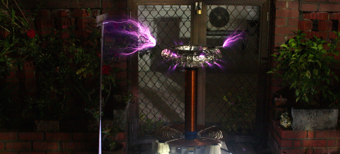

Hello, I was wondering if this https://www.katiludalys.lt/katilu-i...s-itampos-transformatorius-danfoss-ebi4-15kv/ transformer is good for powering up a tesla coil?
Hi, what you mean voltage rating? Im planning to build one and Im wondering if this power supply is good for thatHi, what is the voltage rating of your Tesla coil
thats the point of asking, i dont know whats inside that transformeris it an ac power supply? Are there internal diodes?
Never noticed the duty cycle part. Real good catch and would fit with it being an ignition transformer. Ignite a flame and its job is done. Not suitable for a Tesla application. Real nice point.Note the "Duty cycle" rating - 33%, one minute maximum in each three minutes.
That may well be one of the reasons it's a lot smaller than a similar rating neon sign transformer, it's got to have cooldown time between uses to prevent it overheating.
Also only 60VA vs. 225VA for 15KV 30mA
