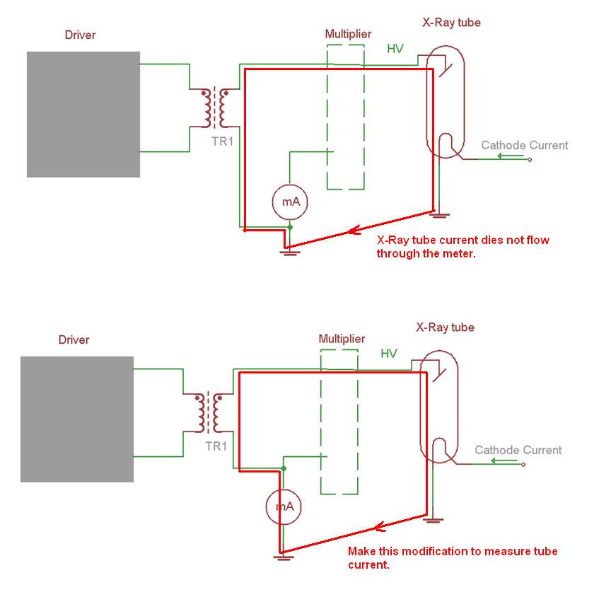

Is it posible to measure current through x-ray tube like that? Is there better option?
No.
Yes, look at my attachment.
You are measuring the current in the first stage of the multiplier, the tube current does not pass through the meter.
Make the change which I have shown and you should be OK.

JimB:
Your correction si right, thank you.
