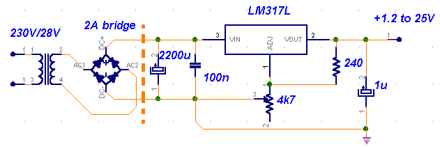

my problem is ... i have no way of keeping the voltage constant. So i was thinking of creating another circuit which i could connect to this one that had a regulator, which would need to be adjustable so i could have full control over the voltage and would need to range from 0 - 15v (DC only)

i have a question about the attached circuit though, as i already have a power supply and just need something to "regulate/vary" the voltage what part of the circuit would i use?
would it just be from the part which i have marked with a dotted line?
or would i have to use the whole circuit and purchase the transformer etc?

Heya Kane,
The two capacitors directly to the right of the dotted line are placed there due to the transformer power supply. The 2200uF capacitor is for ripple filtering and so that the voltage is supplied from the capacitor, rather than the bridge. This is setup to allow smoother voltage to the remaining regulator circuitry, as well as protect the bridge from overheating from "constant" use. In other terms, the 2200 uF capacitor is the the middle-man who takes the raw material from the transformer and refines it for use by the circuit. The 100nF capacitor is installed for a high frequency response, again for the supply voltage and additional smoothing of the voltage to the regulator circuit. Thus, the 100nF capacitor is the retail store which puts the finishing touches on the product and supplies to the customer, which is the LM317. A final note, these two capacitors are there to filter the input voltage from the transformer.
You may need to do a little investigation. If the power supply that you already have (The train power supply) is only a transformer and a bridge, you'll need to include the circuit as you have labeled with the dotted line.
If the train power supply already has some sort of filtering capacitors (If you see a large capacitor in the range of a couple thousand uF) then you should be okay with eliminating the 2200uF capacitor. In this case, I would leave the 100nF capacitor in the circuit (which is what the datasheet specifies for input voltage filtering) Thus, you're just eliminating the 2200uF cap.
Another point Kane:
I used the exact same circuit diagram for my regulator circuit. Be advised that the numbers on the schematic don't correspond with the pin numbers for the devices.
For instance, in the schematic, the numbers surrounding the LM317 aren't defining the actual pin numbers. I think the numbers are there from some CAD/drawing program which automatically places the numbers at the connection points for the devices.
So...be sure to check for the proper pin outs for the LM317. By the way, the "IN", "ADJ" and "OUT" are correct. I just didn't want you to get confused with the numbers. I almost did. :oops:
Final point, I swear
Also, you should know that the LM317 regulates the positive voltage only. If you want to regulate the negative voltage, you'll need to add a LM337 IC. See the below link for how to do this.
https://www.aaroncake.net/circuits/supply3.htm
Last, but not least, be advised that the LM317 will only handle up to 2 amps of current, so if you're planning to draw more than 2 amps, you'll need to go with something else. Also, the LM317 (and the LM337) will produce heat, for the amount of voltage and current that it is regulating.
For instance, if the input voltage is 30 volts at 1.5 amps and you've adjusted the output voltage to be 5 volts at 1.5 amps, the IC is going to generate a lot of heat due to the voltage that you are dropping. Thus, a proper heat sink is required for the LM317 and the LM337. Finally, I think the LM317T is designed with a thermal shutoff, which shuts itself off if it becomes too hot, or if it is supplied with excess voltage / current.

right .... i think im almost their now
about the 2200uf capacitor ... the transformer is enclosed in a metal case type thing so i a unable to see the circuitry, so what should i do?
would it harm anything if i did put a 2200 in just incase?
also a question about the output voltage. In the schematic it shows an input voltage of 28V and and output of 1.2 - 25v
my input voltage will only be around 12-15V (measured straight from the terminals - even though on the casing it says only 12v)
so what could i expect for the output voltage?

i think im jus about to answer my own question (lol)
right from what ive read the input voltage needs to be around 3v greater than max output voltage (so on mine if this is 15V my max output would be 12v?)
and i looked at other regulators on nation.com and the lowest value of Vout is 1.2 so i guess i will just use this one :p

is the 4k7 a variable resistor or potentiometer?
and how can you tell?
Kane
It's a potentiometer wired as a variable resistor. Generally variable resistors aren't available, there's not much point when a potentiometer does the job by ignoring one pin.
