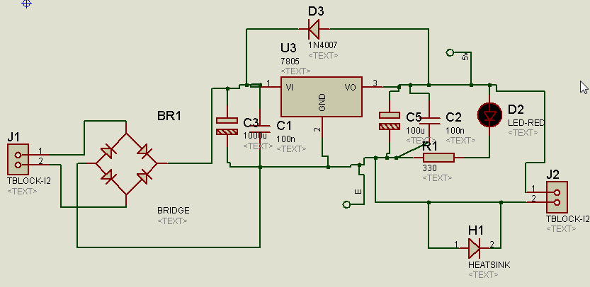

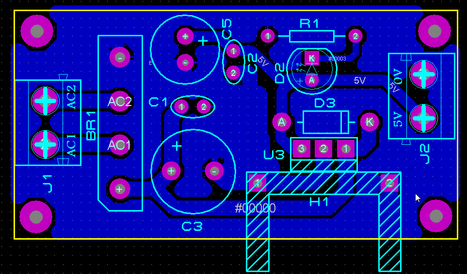

What is the spec on the supply transformer secondary.? [B said:12V /1A[/B]
E
I guess you know that for an output current of 1 amp you will drop at least 7v across the 7805, that is 7 Watts.
On lesser load currents the smoothing cap could charge to [12 * 1.4] - 2 Diode voltage drops, that is approx 15V.
E
i dont know that
what are the effects of these values ?!
If you drop the transformer to 9V your regulator won't get as hot.
you mean get 9v transformer instead of 12V?
if i change the regulator from 1A to 2A ,does this affect ?
However, the 1,000uF capacitor on the input may be too small - it you can fit a larger capacitance it would be better - maybe 2,000uF 25V - may be 16V.
i will use 2200uF ^^

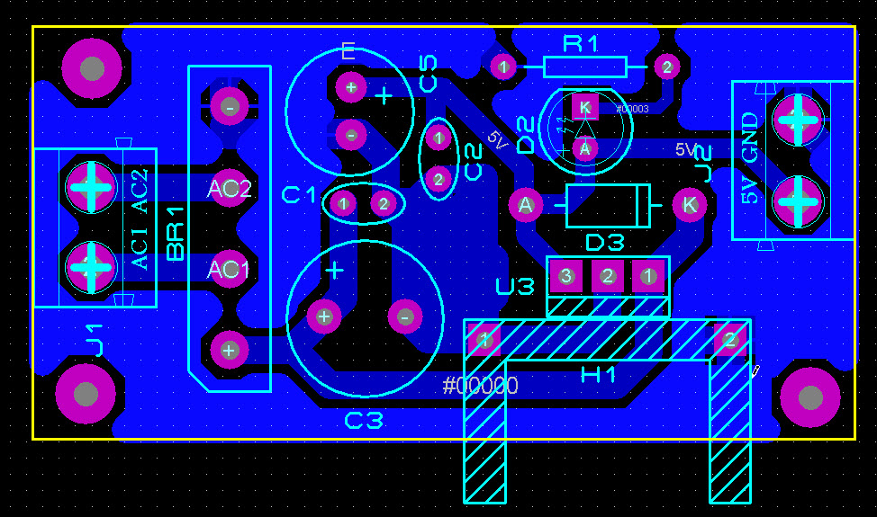

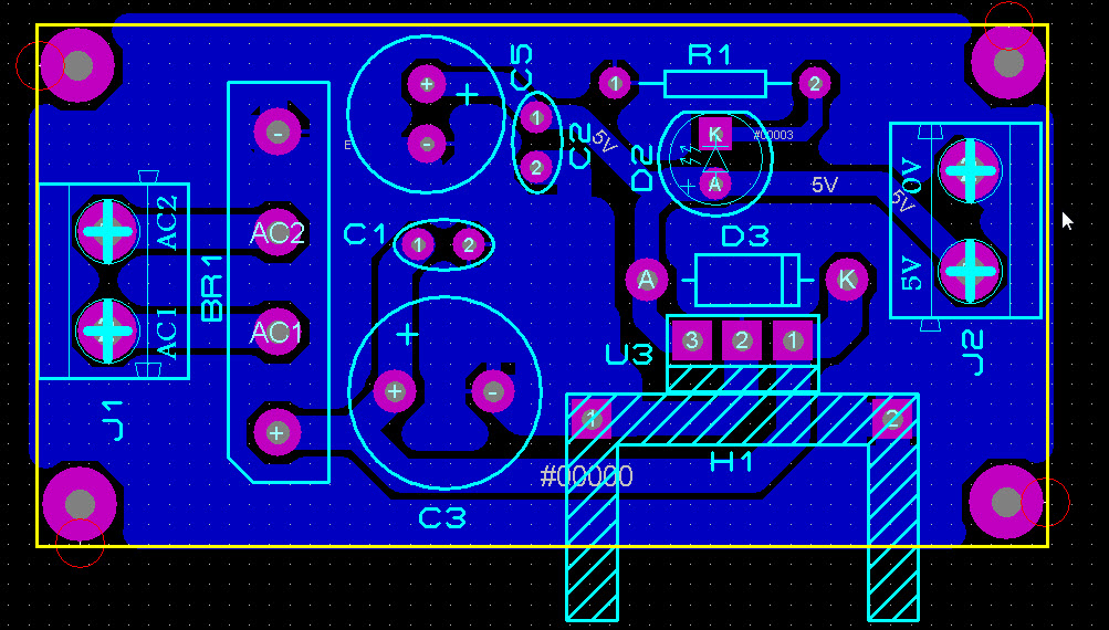

This is "picky". I would make the grounds stronger.
Example move R1 to get ground across the top.
Try to get the right side ground to reach U3-2 more direct.
Try to get C1,2,3,5 to connect to J2 better.
I like your new ground!
I see these red circles. Why? Did you move the holes? I think something is not right.
hi emb,
If the PSU was for a bench testing supply, I was going to suggest adding a 7809 [9v reg] ahead of the 7805.
This would mean you could use the existing 12V transformer, reduce the heating in the 7805 and giving a +9v and +5v supply for your projects.
