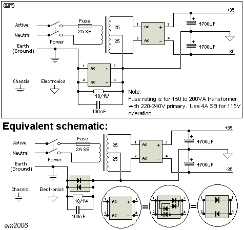

Well here is the schematic:
I'm not sure what type bridge rectifier to use, there are so many to choose from. I want a reliable one.
What's the turns ratio on the transformer? If it's 20 to 1 it's a 12 volt supply, and you're going to get a max of about 20amps on the secondary. So pick a full bridge rectifier that can handle 20 amps, if you want better reliability try a 40amp rectifier as it'll put less stress on the diodes, you pay more though. Not sure what you mean by types of bridge rectifier to use. They're pretty simple and standard, four diodes.
Its made to be a 35v supply. The only thing it tells me about the transformer aside from the schematic is that it should be a rating of 150VA (3A) minimum.
The place I got this from also states to use a 35A rectifier.
Which is fine, however when I am looking to actually buy one, I need to specify three phase or single phase. I assume this is going to be single phase since its not being used on a huge power line. However, I was not aware there was a distinction. Why couldn't a single phase rectifier work on a 3 phase signal?
Anywho, what I was mainly looking for was a brand reccomendation.
Oh, and would a 200V rating on it be overkill?

Then why not follow Elliott Sound Products advise?.
Three phase uses more diodes (six instead of four), but I've never heard of being asked that if you ask for a bridge rectifier.

No, that's fine - and probably the value you should be looking at.

i have never seen a schematic like that before. what is the second rectfier from the center tap going to earth ground?
If you notice my previous post?, I said it came from Elliott Sound Products, the article there explains why it's done like that!. It's from a guitar amplifier, and it's to prevent earth loops.
but why the rectifier parallel to the 10 ohm resistor. wouldnt all of the current go through the resistor unless the current got high er than .7 volts to pass through the diode?

The equivalent schematic is like in attached BRIDGE.PNG.
I don't well understand why diodes are necessary, the voltage drop across them means power loses.
Diodes are antiparallel connected, so each diode conduct a half cycle,and 10/1W resistor become short circuited. (I think, effect of resistor is only active when diodes are blocked, around zero crossing of line voltage).
Efect of capacitor parallel is well known, bypass for high frequency.
What happen if a fault occur and a diode only become interrupted? A continuos component may be appear. This is not good for trafo.

As my previous reply - READ THE ORIGINAL ARTICLE - it explains the reason for it. If you can't work google?, it's at **broken link removed**
