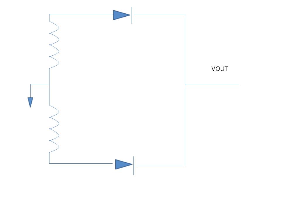

The microwave transformer won't work. Forget about it. Try connecting the secondaries of the 18V transformers as show below, and measure the VOUT. I'm thinking it might be 26-28V, hopefully, then you can use the two 18V transformers to get your 24VDC.

Oh yes, I didn't think of that, are you aware that the filtered DC output will be near 24VDC?
I'd probably recommend full wave rectification over biphase though.
The reason was to save a diode drop. It will still be full-wave. I was also thinking that if the transformers are 18V @ 4 amps, they might be slightly more if lightly loaded, maybe 19-20V. If so, then he might have enough headroom for a regulator. Of course, he won't get the 8 amps he was looking for, probably the origianl 4 amps is more reasonable.

you should NOT do that directly. mismatches between the transformers will cause problems. think in terms of an extreme case - a 1:1 in parallel with a 1:1.1.
on the other hand if you use separate rectifiers for each you will be able to run even if it does not share current equally at low loads.
