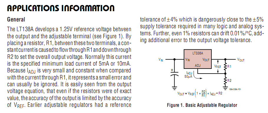

Here is my diagram for PCB (Two LM338 power supply):
the resistor R1 is 270Ohm
the resistor POT1 is 1450Ohm (250Ohm adjustable and 1220Ohm not adjustable)
My problem is: I get 18V (I want 12V) out and it barely asjusts but acording to this formula here
My AC transformer is 15Volts.
I need max POT to be 1480ohms (my VREF measured between Vout and V adjust is 1.8V).
if you are getting 18Vout with those values,, either the pcb is incorrect or the LM338 is blown.??
Using the formula: assume the 250R is set to 0R
1220R/270R = 4.51
plus 1 = 5.51..... times 1.25V = 6.88V ... you can ignore the small Iadj part.!

Your value for R1 and for the pot are too high.
R1 must not be higher than 120 ohms for the LM317, LM338 and LM350. It must not be higher than 240 ohms for the more expensive LM117, LM138 and LM150.
Or the output voltage might rise without a load as described in the datasheets.
Then of course the value of the pot must also be reduced to go along with the lower value for R1.
