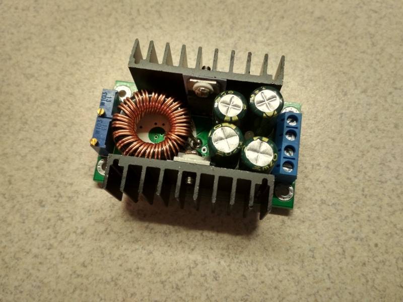

PWM from BangGood
Think about this little board. The input needs to be 40 volts or less DC. There are two pots to set voltage and current limit. The output is 1.25 to 35V or Vin-5V which ever is lessor.
Because it is PWM there should be much less heat.
I think this is the same thing but with a fixed 8A current limit.
PWM 8A

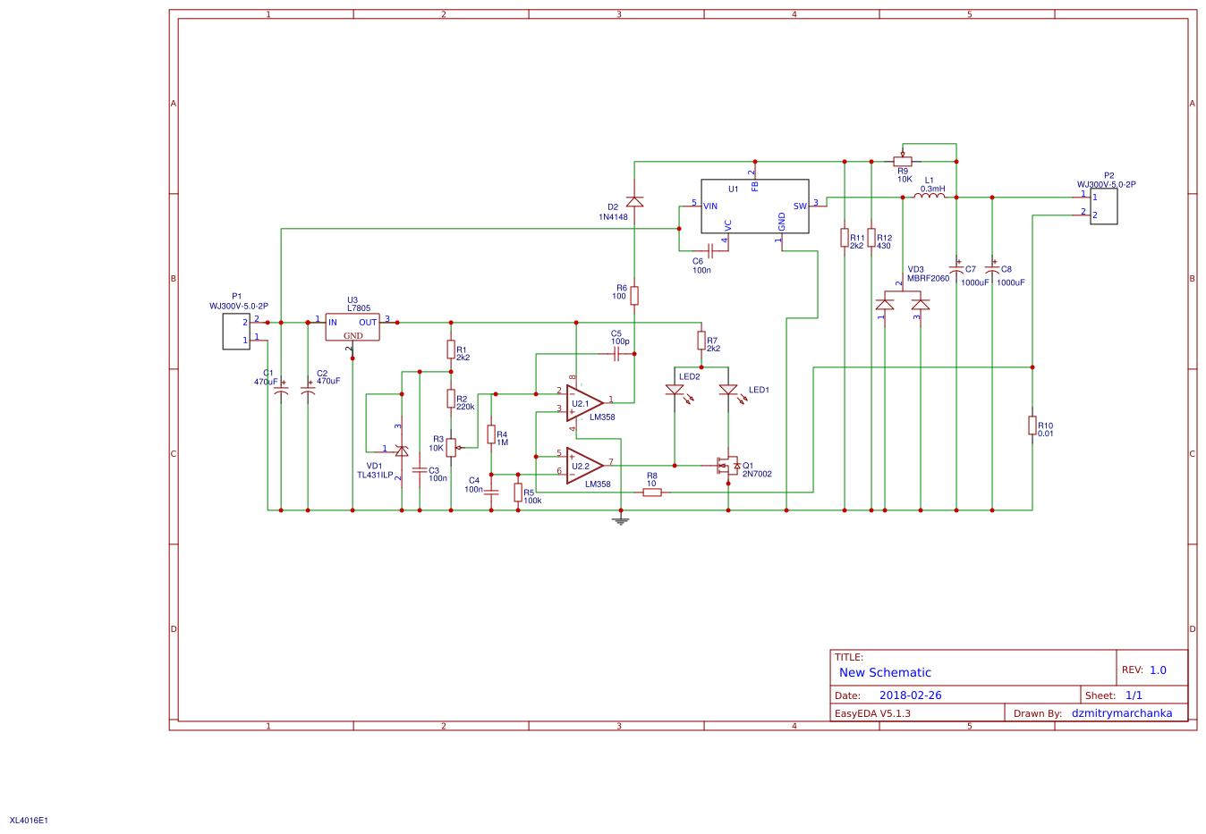

Hello, I would like to know if there can be added a fast constant current protection for the attached power supply schematic ?
If yes, can you show me a possible schematic for the fast constant current limit ?
Thank you in advance.

I have a question about connections in power supplies, generally speaking.
If a power supply is oscillating, then is it possible that a bad connection will dampen the oscillations ?
For example, a bad connection in a connector located on the collector of the power transistors.
if by bad connection, you mean one that has high resistance that could dampen the oscillations, then, yes it's possible. a bad connection somewhere within the feedback loop can cause oscillation as well. it depends on what component. another thing to keep in mind, is electrolytic capacitors, when they begin to dry out, have high ESR (Equivalent Series Resistance), which reduces the cap's ability to filter out high frequency noise and oscillation. usually, you can't tell by looking at them that electrolytic caps are dried out. sometimes they swell, or pop the top open. but the vast majority of them look ok. when you test them with an ESR meter (which is a 50khz or 100khz oscillator and an attached meter that reads the AC voltage across the capacitor) you can see immediately which ones are good or bad, and in most cases don't even need to remove them from the circuit to test them.
also, having 100mV ripple or noise riding on a 10V output is 1%, which is good enough for most uses. there are times you might want a very quiet rail voltage, but for most stuff, 1% is ok.
