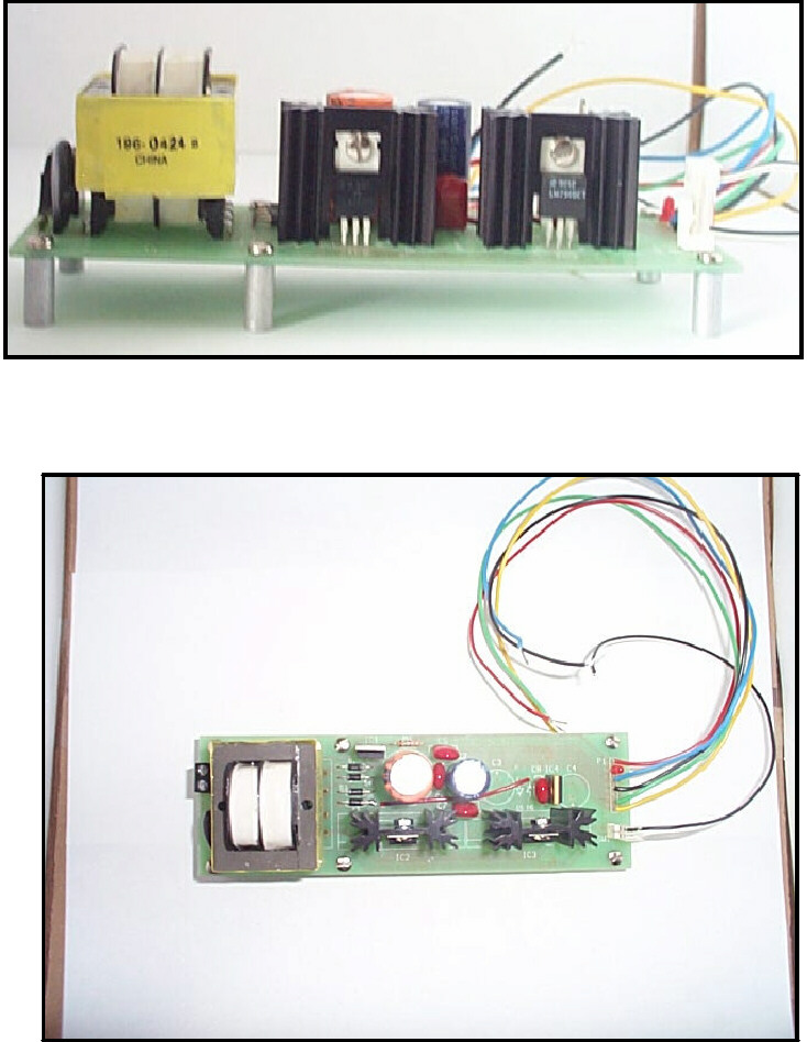

Experimenters Power Supply
I have a few of these powersupplies left. They were created for experimenters. If anyone is interested in them, I am selling them for what it cost to build them. If you want one send me a private message and we can arrange the details.
These are the specifications:
This powersupply was designed for the experimenter, as it supplys 4 regulated voltages at one time. It operates from 120V 60 cycle AC, primary power. The maximum combined currents without overheating the power transformer is 600mA. The output voltages are +12V,+9V,+5V and -5V. They all share a common ground connection.
The +5V and ther -5V requlators are mounted on heatsinks and can each supply indivually 600mA on a continous basis.
The +9V can supply 300mA on an intermittent basis, but can supply 75mA on a continous basis as the regulator is not mounted on a heatsink.
The +12V can supply 125mA on a continous basis.
With this power supply most op amp circuits, digital, and speaker amplifier circuits can be powered at the same time, as all voltages are availible at the same time.
In addition to the power supply as shown, it comes with a two conductor power cord with a molded plug on one end and pigtail leads on the other end. The power supply is supplied with 1/2” threaded spacers, but the spacers will be removed from the circuit board for shipment.
Not shown in the picture is an LED power on indicator connected to the circuit board, and a on/off switch.
They also come with a schematic.
