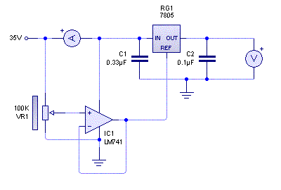

hello guys,i'm a newbie here..i am a student from philippines.we have a project in electronics..cn u help me how to make a simple power supply..thx...:)
This is a nifty little variable power supply using a L7805, thats right a fixed voltage voltage regulator, i have never made it but in theory it will work and could be built to fit into the palm of your hand, it's output voltage is variable from 6.5-35VDC, with a 35VDC input, i'm not to sure it would work well at the lower voltages due to the enormous voltage it has to drop and therefore the enormous amount of heat it would produce, a good heatsink is required. If you wanted a good reliable power supply get a LM317, i have a few, if you need a diagram search on google for the datasheet, the LM317 costs about £1 and requires few external components to operate reliably.
hope this helps:)
hope this helps:)
That won't work, it'll just give Vin*(Position of VR1) + 5
Where "Wiper position of VR1" is 0 with the wiper at 0V and 1 with it at Vin, except it'll never reach Vin, the maximum setting would be Vin - 2V

The 7805 power supply above would have the heatsink above ground potential, I know from the ones I've built it can be a pain.
