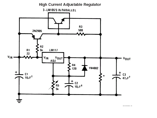

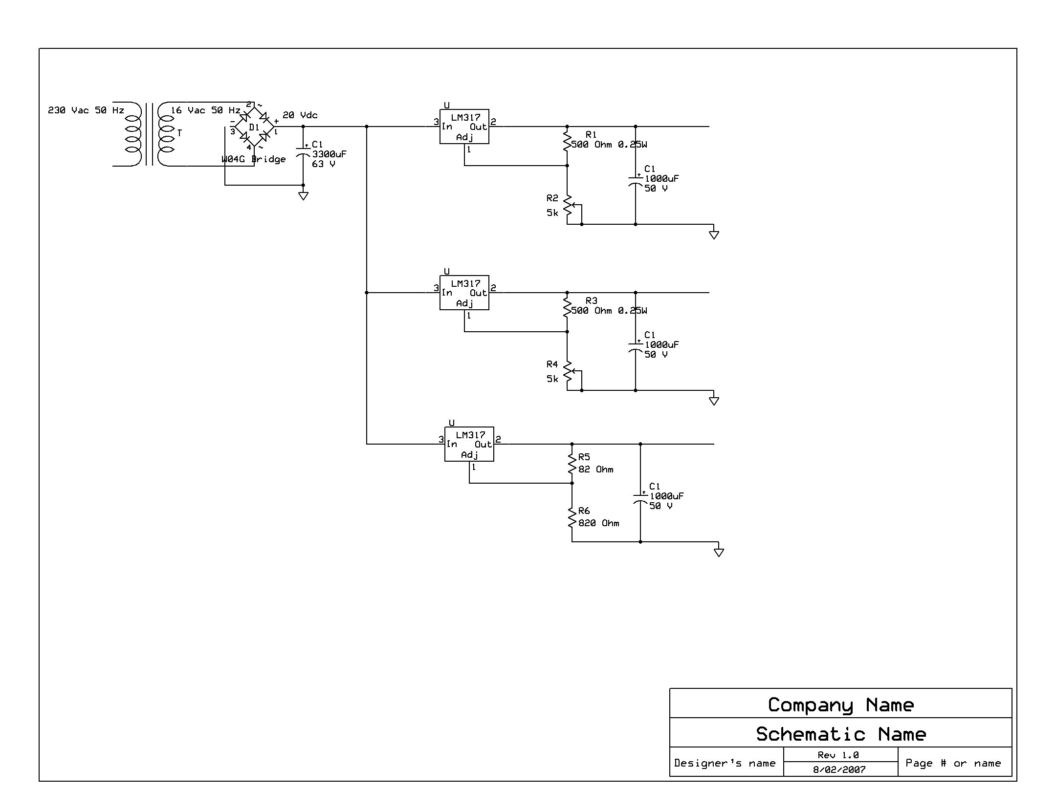

I am building a power supply for a train set. The PS has 3 O/P, 1 12V ±3A and 2 variable 12V ±1.5A suplies. Now the problem I am getting is that I am not able to supply the required current, as soon as I connect the required load the O/P voltage drops from 12V to 6V. I tried connecting a power transistor to supply the extra current but when it is turned on I only get the I/P voltage to the regulator at the O/P? I would like to know how I can get the extra current if there is a way. The regulator that I am sing is LM317, smoothing cap form rectifier is 3300uF O/P smoothing cap is 1000uF. For the static 12V R1 = 82:eek:hm: R2 = 820:eek:hm: and for the adjustable: R1 = 500:eek:hm: R2 = 5k:eek:hm: would appreciate any advice as how to resolve this.
This is sort of what i want to use, it's just the basic layout of the circuit.
These are the circuits i used as refrence to try and increase the current.

Hello Kraglaan
What you've typed doesn't really make much sense. Please post a schematic to clear things up. Make sure to include transformer ratings.
R1 should not be more than 120 ohms for an LM317 and not more than 240 ohms for an LM117 or the output voltage will rise without a load. It can be less if you want.

Well you could buffer it, but you would lose the over current protection. The LM317 can only supply 1.5A.
On the other hand you would get better low speed torque if you PWM it instead.
D.
What sort of load are you using?
The LM317 can't supply 3A (unless you're very lucky) the current rating will go down as the input-output differential increases.

If the power supply is capable of 6 amps (12V@3A + 2X12V@1.5A) then connecting the outputs thru diodes will fix the problem. But, if the supply is only capable of 3 amps (12V@3A or 2X12V@1.5A), you are stuck and need a better supply. Adding a transistor cannot increase the current.
Diodes aren't good idea because of the associated voltage drop; adding a booster transistor is normally the preferred option.
LM317 can provide a max of 1 amp...no question of getting 3amp.
3 amp regulator has to be made from scratch.
also for proper functioning of 317regulator..Vin-Vout should at least be 3volts..

The thing is that i tried to use the booster transistor from the pdf file
but instead of using the lm195 I tried to use a FET now i am not sure if the result should be the same or diffrent but i thought that they should function in the same way. After the FET did not work I tried to use a diffrent power transistor similar to that of the lm195 and still the input was just taken straight through to the O/P so I don't get how the booster configuration can only supply more current and not act like a dirrect sort from I/P to O/P.
Can you explain to me why I can't use more than 120:eek:hm: for R1? Also would diodes not work if you bridge them accros the LM317 and change the resistor values accordingly?
A Mosfet is completely different to a transistor. It needs about 5V to 10V from its gate to its source to conduct. A transistor needs only 0.7V from its base to its emitter.
When more than 30mA flows through the 22 ohm resistor into the LM317, the PNP transistor turns on and turns on the LM195 transistors. When enough current flows in the LM195 transistors then less current flows in the LM317 and it turns off a little, enough to regulate the output current.
The operating current of the LM317 circuit flows to its output pin. It max is 10mA for an LM317. If R1 is 120 ohm then it is a load on the output of the LM317. Its current is 1.25V/120 ohms= 10.4mA. If the operating current is 10mA and you use a resistor value higher than 120 ohms for R1 then the output voltage will rise when the external load current is less than a few mA.
The max operating current of the more expensive LM117 is half at only 5mA so a 240 ohm resistor can be used.
The resistor values determine the output voltage. Diodes connected in reverse protect the IC from capacitor discharge damage if the input or output is shorted to ground.
