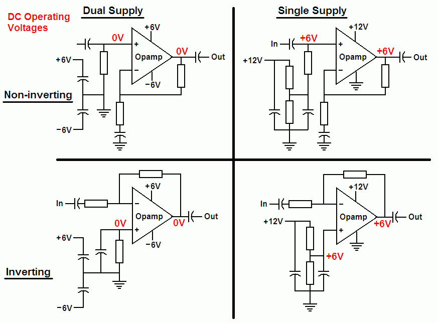

If you bias the input of an opamp at half the supply voltage then it can be inverting or non-inverting and use a single supply voltage like this:
Yes provided you do not exceed the maximum rated voltage of the op amp.
If the negative terminals of your supply are not connected together internally (measure with a DVM), you can make a +/- 5V supply by setting the variable supply to 5V (for the +5V) and connecting the positive of the 5V fixed to the neg of the varaible supply so that the neg of the 5V fixed becomes -5V.
Ground then becomes the fixed +5V pos/variable neg connection.
However you can still use a single supply for op amps which accept them (eg LM324) by biasing it so the output sits at a dc level of about half the supply voltage when there is no input signal present.
