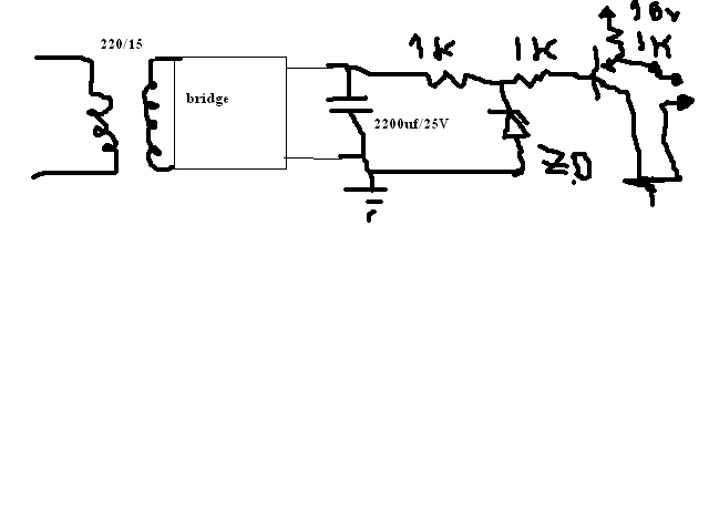

1st: I've got an interview and it was required to design a 15VDC 1 ameprage , i didnt remember that there is a 7815 IC , so i put a 15V zener at the output with series resistor 1k , i tried to increase the current output , i put a PNP transistor after the zener , i know its wrong , but i want to know how my idea can be designed ?

Nigel, oh you mean the basics about power supply design ? I dont mean that , i mean the final stage of the power supply , i couldnt design it good , i put a 15V zener , but it will deliver with 1k , 15mA , and it was required a 1A power supply , so i put a PNP transistor to increase the current rating , but i know its not correct ...
I know the final stage isnt correctly designed

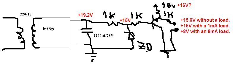

You have a 1k resistor from 16V(?) feeding the load.
The transistor keeps the output voltage from rising above 15.6V without a load.
When the load current is more than 0.4mA then the transistor turns off.
You might have used an NPN transistor as an emitter-follower. The circuit would be so simple that I will leave it for you to figure out.

It wasn't 16V , it was 15V (VCC of the transistor) , but whatever using a PNP or NPN , I cant draw up to 1A , that was my problem in the design is mainting a constant 15V with 1 amp that is why i put that PNP , i dont know what an emitter follower will do in that circuit it will just make the base follow the emitter e.g 15V .

A TIP31 NPN transistor as an emitter-follower can supply 1A to a load when its base current is 40mA. A zener diode will keep the base at 16V so that its emitter will be near 15V.
The 15VAC transformer makes 19.2VDC after it is full-wave rectified and filtered.
Use a 68 ohm resistor feeding a 16V/1W zener diode. The base of the TIP31 transistor connects to the zener diode.
The TIP31 transistor will heat with about 4W so it will need a small heatsink.
The output voltage will be +15.4V without a load and will be about +15.2V at 1A.
If the output is shorted then the transistor will get extremely hot.

Thanks alot , yea i got it now , but what i really wanted to do is current sink , not a source , that's why i used a PNP transistor , how can i change the design to use it ?
also another question for the design above, why i didnt put a base resistor and a collector resistors ?
The 68 ohm resistor is the base resistor for the emitter-follower transistor. It also feeds the zener diode. The zener diode stops the output from rising above about +15.4V.
If you added a collector resistor then it would limit the current and the output voltage would drop.

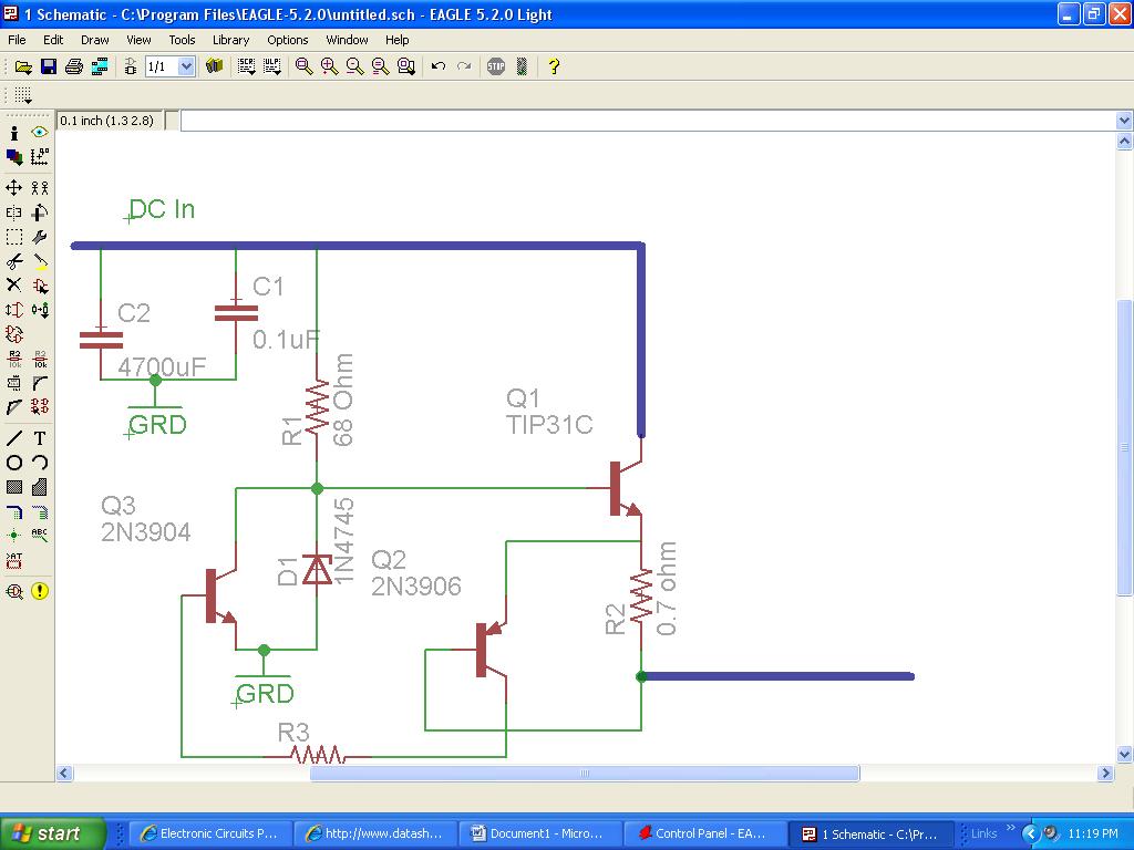

The circuit is speced for 1A. The TIP31 will draw up to 3A. He needs some sort of over-current protection, which will also prevent damage from short circuit. View the attached schematic. Someone else may have an easier method. Also, something I noticed that was inconspicuously missing was a high freq. cap (0.1uF) for RF filtration. Did I miss anything, schematic wise? There is a way to do this using one transistor, but the design escapes me. Other thoughts?
p.s. Please forgive the crude drawing. I'm still getting the hang of Eagle.
You can. But I'm with Andy257. Why not just use an IC regulator such as the LM350? All that' required is a voltage regulator on the output fed back to the adj. pin. you can still use the over-current circuit using one NPN transistor. It would be a simpler design and probably easier for you to remember. I can supply you the details for the over-current if this is a route you wish to follow.

If the output is shorted then the poor little 2N3904 transistor in your circuit will try to sink 279mA. Its max allowed current is 200mA and it has hardly any gain above only 100mA.
The 2N3906 transistor will not give it enough base voltage to the 2N3904 so it might conduct 140mA with 10V across it and then burn with the resulting 1.4W.
The 68 ohm resistor also might burn.

Hi AudioGuru,
Your right about that. However, if you were to use a TIP122 which has higher gain and can saturate with lower base current this would be a better design for my circuit. Using just one 2n3904 transisor with the base/emitter across the current-sense resistor (emitter connected to the DC out and base to the emitter of the series-pass, the collector would go to the base of the series-pass. The 2n3904 would monitor the current, when it conducts, it would divert current from the base of the pass-transistor, thereby limiting it's current output.
I did not redesign the circuit, because ahmedragia21 has made it clear what he was after. I just wanted to explain further.
