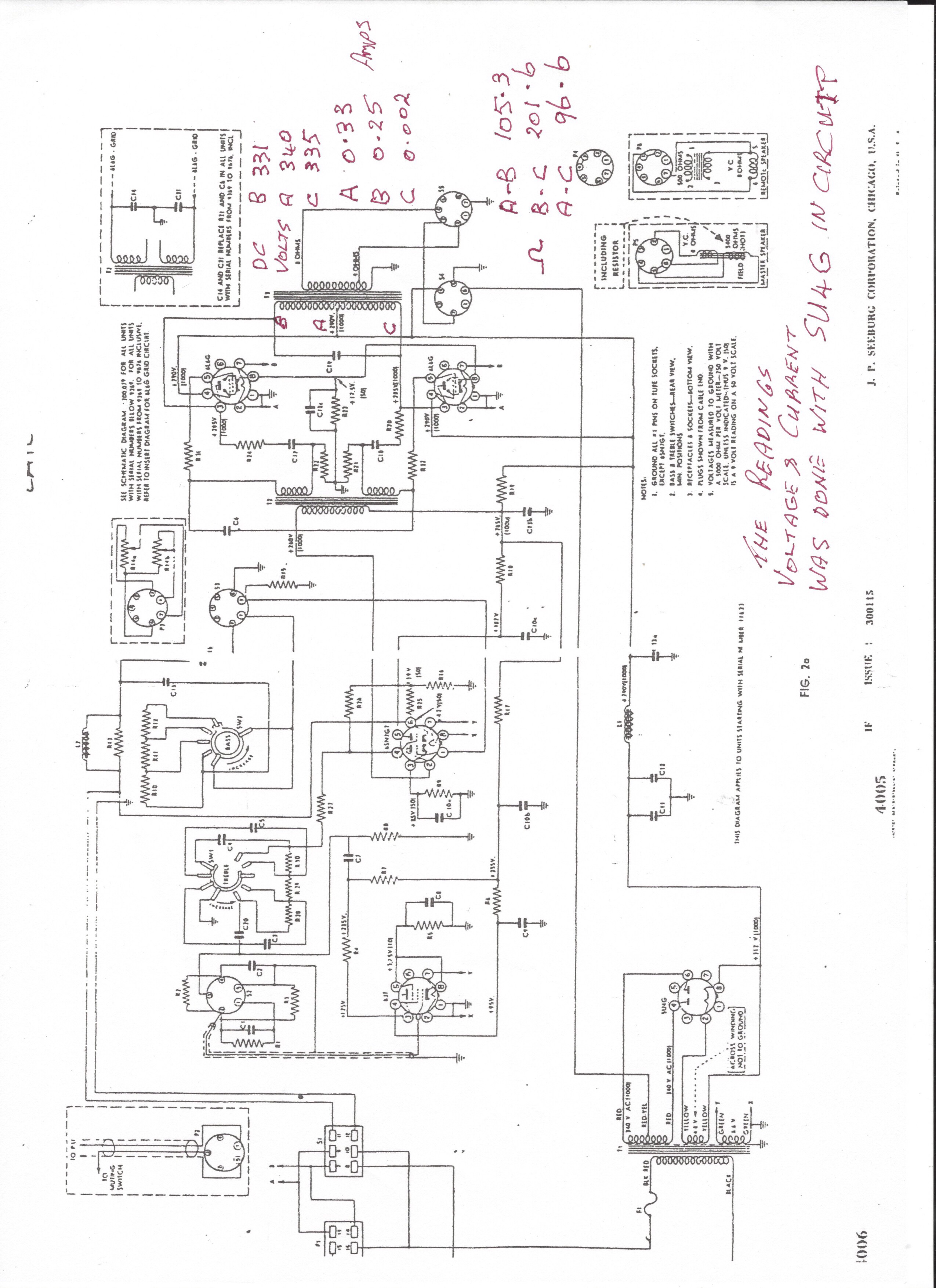

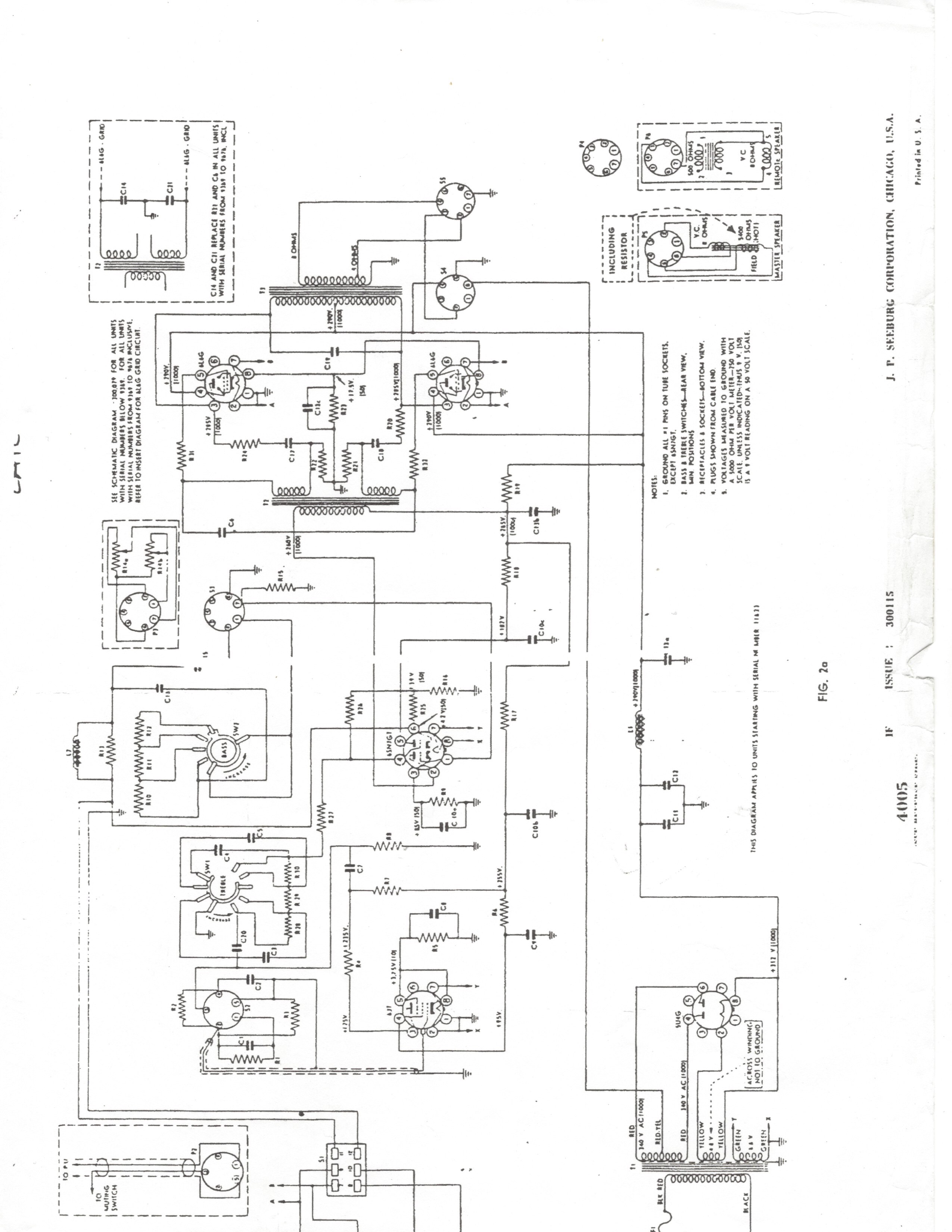

I am rebuilding a valve amplifyer for a Seeburg 148 music box.
I have finished the rebuild of the main amp and have the pree amp to do.
I powered the main amp up with a load and every thing is ok but the audio power amp is down in resistance between the center tapping and the other two takings . Which causes a audio problem.
I am looking at punching a new transformer but the only information I have is the voltage in and out I need to find out the power rating of the transformer.
Can somewon help me with this.
I will post a circuit

I will attach a circuit with the readings ? When I did the reading with the SU4G valve removed the reading was very low volts can you explain. If the valve is removed the reading would be Ac is that correct.The readings wer done with the valve in circuit. The dc voltage was done respect to ground.
The current reading was done with a clamp meter.

From what you say, I have some suspicions.
For example, why use a clamp meter to measure DC current when the currents are only up to about 250 mA. I wonder what test equipment you have.
If the transformer is faulty, then take it out of the circuit and apply a test signal of say 5 Volt AC from the heater supply to the output transformer secondary and use an oscilloscope to measure the voltages across each half of the primary. IF the transformer is faulty, then just get it rewound.
My guess is that with 6L6 output bottles with a 300 volt dc supply, the power rating is around 15 watts. The power supply transformer will be about a 30 watt rating for the dc supply plus about another 30 watts for the heaters. That makes about a 70 or 80 watt power transformer.

The T3 Audio transformer has
1960 turns on the primary wirer dia is .15 mm
The secondary is 86 turns 1.16 mm dia
Can you work out the current rating from this information.
With the T3, this is an impedance matching transformer and from the info given it is about a 5000 ohms plate to plate impedance to give an 8 ohm output impedance. The tapping for 4 ohm would be at about 55 turns at a guess. The turns ratio suggests an impedance transformation ratio of about 450 or so.

On my previous post I submitted a circuit digram and the voltage is 290v dc but in brackets there is 1000 what does this mean

...On my previous post I submitted a circuit digram and the voltage is 290v dc but in brackets there is 1000 what does this mean
The "(1000)" you're seeing is the suggested test voltmeter scale* to be used to measure the 290 VDC noted on the schematic - look closely at the "NOTES" section, line 5.

Yes please . I tested the resistance between the 3 tappings as shower on the no 3 post ,circuit digram with all wires disconnected.
Would you know the power rating af the transformer.
I will post the iron field measurement . Hight. Width . Bredth. If this is of help to you.
A to C on that circuit digram posted.
