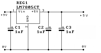

The LCD should be powered with 5v and I'm currently using three 1.5v batteries. Now that I'm going to put the circuit in a box, I would like to power it using a 9v battery and I'm not sure how to do that. Will this circuit, http://www.hut.fi/Misc/Electronics/circuits/psu_5v.html work with a 9v battery?

If I understand the circuit on your hardware page, **broken link removed**, correctly, you have connected the voltage regulator in a way similar to the page that I mentioned, http://www.hut.fi/Misc/Electronics/circuits/psu_5v.html. The difference is in the values of the capacitors.
Should I connect the voltage regulator like in the picture that I've attached below?

Yes, that's fine - you don't need to use C3, that was just a capacitor added close to the PIC (which is always good practice).
The values are very uncritical, I used 1uF because they are small, and I had them handy. You must use capacitors near the chip to prevent it oscillating.
