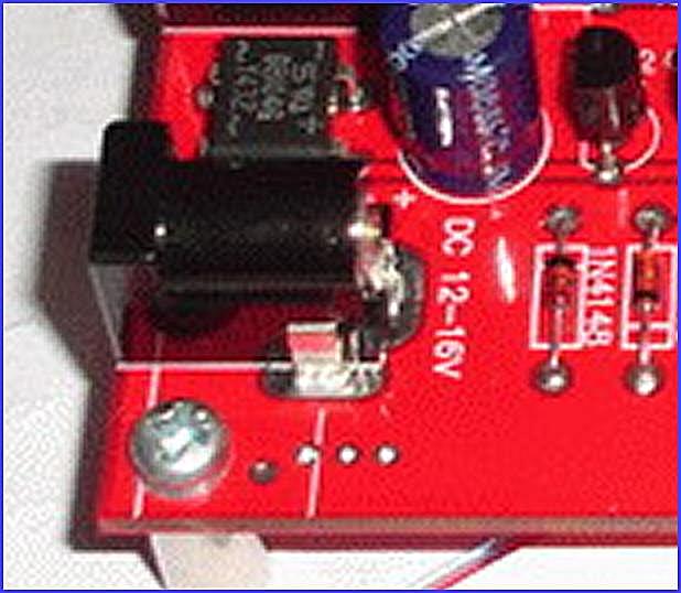

Looking at that picture closely, I see what appears to be a full-wave bridge rectifier just above the power connector at the bottom left of the board so you should be able to power the board with an AC or DC power 'brick' or 'wall wart' power supply...
It looks like there's a 78L12 regulator in a TO92 package with two diodes below it for developing approximately 13.2v for VPP and that will be the highest voltage on the board... Add 3 volts to that for a total of approximately 16.2vdc at the input of the 78L12 regulator...
An AC power 'brick' with a 13-16vac 100ma rating or a DC power 'brick' with a 16-19vdc 100ma rating should work fine... But you won't know if the Power Jack is 2.1 or 2.5mm type until you get the board...

In addition to what Mike said, I would add that because the smoothing capacitor is so tiny, you are better off using only DC for the board. In fact, the voltage range is already printed on the circuit board.
Then the full-wave bridge rectifier must have been included in the design to allow for "any polarity" on the power plug... Good idea...
Unfortunately, the full-wave bridge will drop approximately 1.0vdc and you'll still need approximately 13.2v for VPP at the output of the regulator plus the regulator voltage drop (50mv for an LDO type or 3.0v for standard type) plus the full-wave bridge voltage drop... So it seems to me that he's still going to need 14.5 to 17.4 vdc...
Perhaps the designer normally sells one of those loosely regulated 12vdc power bricks that actually puts out something like 15vdc without a load or under light load... This type of 12vdc power supply should work fine...

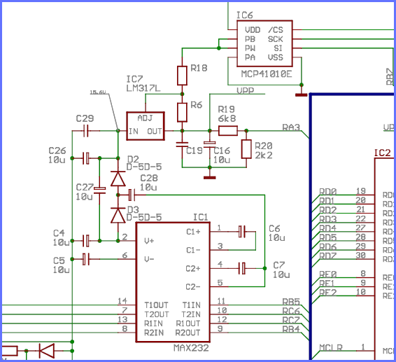

Yes, I noticed the 12V too. I think the board could be using a voltage triplier with the MAX chip to generate the 13V but I can not tell from the board image. This is a similar design I saw on the net the other day.
But the 12V DC brick (which gives +16V output unloaded) is definitely more likely to be the true reason in this case.
