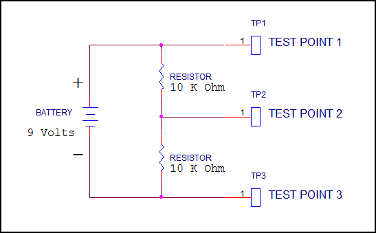

Take a look at the attached drawing. If I take my common meter lead a place it on TP-2 and use my + meter lead and measure from TP-1 and TP-3 respectively what voltages should I read? The battery is a 9 volt battery.
There is no actual negative voltage in the circuit you have. It is a matter of the point of reference. When you took your readings where was your meter negative lead connected? Think about moving the meter leads around on the circuit I attached. How about if you place the negative lead on TP-1 and the positive lead on TP-3 what will a DMM read as to voltage?

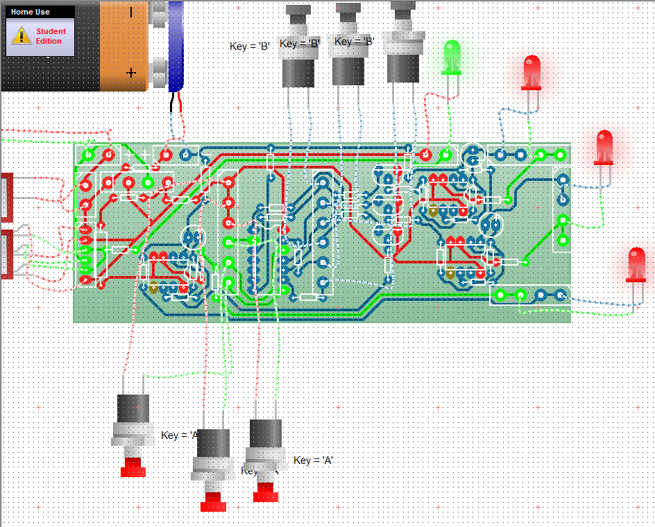

I didn't place a DMM anywhere - this is in a simulator of the "Circuit Wizard" software package.
Pretty sure it is a negative voltage not point of reference - it's present throughout a huge chunk of the circuit.
I can't post a schematic because the schematic works fine - I did something wrong when making the PCB.
I can't demonstrate it properly in a pic, because it's just a messy PCB with no labels and a load of offboard components - but here's a screen shot with everything spread out a bit more.
I appreciate that it's impossible for you to follow, I just want to illustrate that it's not just a couple of points that are negative - in the shot below, everything blue is -3.16v.
And everything that's at -3.16v should be 0v. I just don't understand why it isn't.

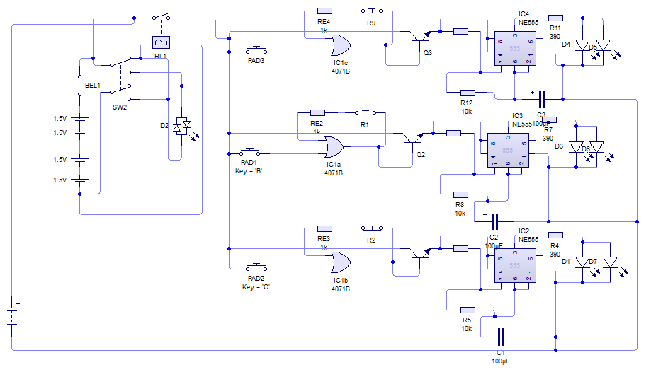

OK, but as I said, the schematic when simulated works fine.
I've stuffed something up making the PCB. But I've dedone it twice and made the same mistake - whatever that is.

There is no ground in your schematic. i have never seen a simulator that will run on a circuit which has no ground.
The negative terminal of the battery on the left hand side of the circuit would normally be designated as ground.
Also, your CD4071s have floating inputs, which is a no-no. The circuit's operation will be unpredictable unless you add resistors to one of the rails (probably ground, but I haven't analyzed the circuit to be able to say that definitively).
Your D2 LEDs have no current limiting, unless they have a built-in resistor.
The LEDs which are driven by the 555s should each have their own current limiting resistor. Parallel LEDs may wind up with one of them hogging most of the current, which will give them unequal brightness, and, depending on current rating, could damage them.
Uh, it's a PCB where would you suggest I put "a ground"?
Fair enough, the schematic doesn't, but it works as fine as I've already said. This simulator is obviously contrary to those that you've used.
The LEDs do have resistors. Parallel.. well that's a design choice - as I say it's a mates circuit not mine, I'm just doing the PCB.

I fixed the "bouncing around" - I'd left out the caps! Really was tired this morning...
Strange issue arose after that though - the LEDs were on solid when the should have been off. Still flashed as should, pressing the breaker sent them back to solid on.
Unwilling to fix it, I just stuck in a 4069 (hex inverter) at the end. Works fine now.
Negative voltage was sorted by removing the 6v supply that switched on the PP3 - I don't know why he had it in anyway, but once I removed it and made some other changes, it worked fine - I presume that's what it was down to.

Have you fixed the floating inputs on your OR gates?
From my previous post:
Haha, no by "sorted" - I mean "sorted", thanks.
As in "it's fine". Cheers.
It won't be fine unless you have resistor (100k) to ground from each input. Sorting does not allow you to find the parts that don't need resistors. ALL CMOS gate inputs need to be connected to something that eventually has a current path to ground.
As I said before, that was already done when you picked up on it - by "sorted" I mean "everything is fine and it works".
The resistors weren't shown in the image you saw because that was the schem done by the mate that I'm doing the PCB for. I scratch built the PCB and made changes myself - such as the resistors to pull down to ground.

OK, I apologize for dragging this thread off topic. Did you ever get the negative voltage issue with the simulator figured out? If not - you must have had to use two probes, since there is no ground in the schematic. Where did you place the "common" probe (negative one, I would think)?
Yeah that works fine now too.
The way the software works there is no necessity to place one probe, let alone two. It simply shows the current and voltage throughout the whole circuit simultaneously, with numbers if you hover over, or a representation through a colour scale.
Varying shades of blue, green and red show varying intensity (voltage) of negative, ground and positive respectively. With current shown by the speed at which its flowing.
Quite a handy tool actually, you can quickly and easily see roughly what the levels are anywhere in the circuit at any time, when outputs are high or low etc.
It fixed after I re-did the circuit without the 6v battery - relay switching on the PP3. I guess there must have been an overlap somewhere there, causing a leakage of negative over the common track.
