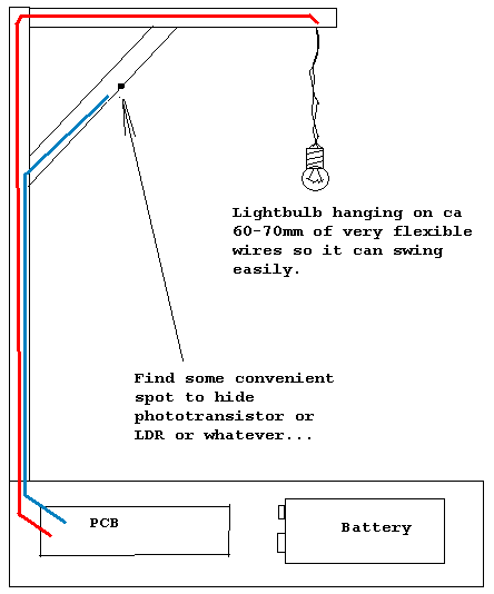

Well, there is a nice old trick with the "hangman" candle.
Just make photosensitive circuit that requires light to turn on
an output (lightbulb). When you bring lighter to "turn on the
light", flame will be seen by hidden sensor and lightbulb will turn on.
Now even after you remove lighter, circuit will still stay on because
sensor will see the illuminated lightbulb. Now if this doesn't impress
anyone, blow at the bulb. Once it swings out of position, photosensor
gets less light and circuit turns off the output and bulb goes dim.
Worked fine for my party back in the old days. I had trouble getting
the photosensor so I removed top of the BC109 transistor to expose
it's guts to the light. It also didn't hurt anyone that time.

Anyone ever toced a transformer of a tube radio reciver.It gave me a good demonstration how electrycety gets mad .
PS:
How do you make a ptotsensor from a transistor ?
