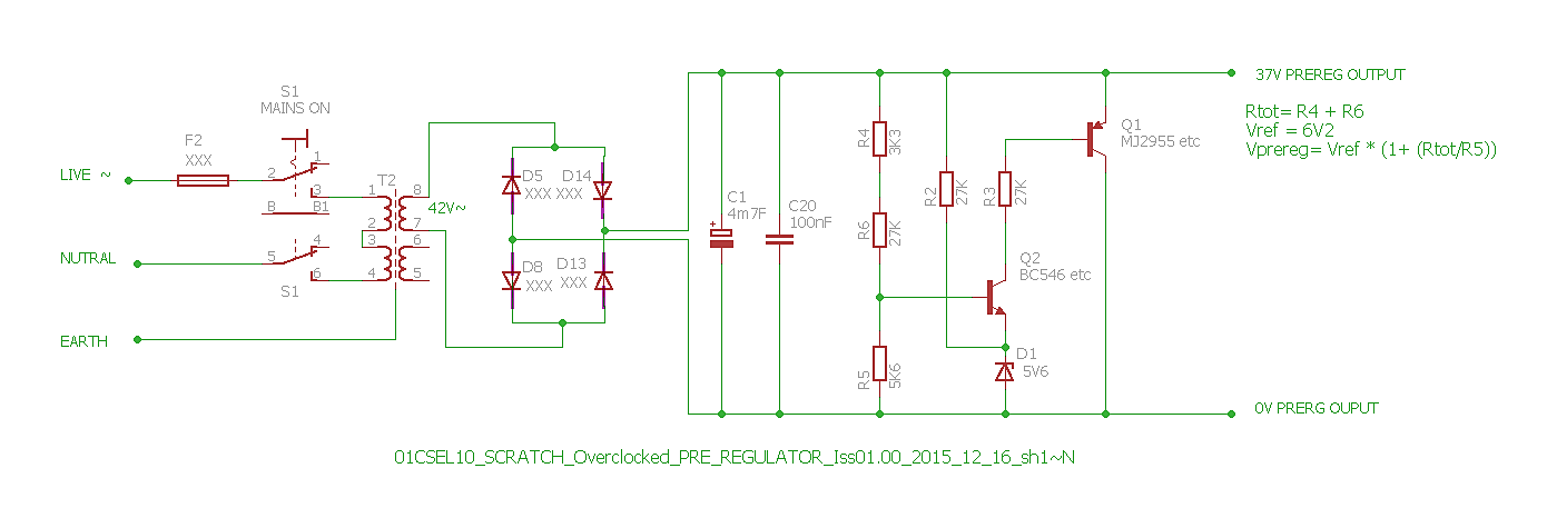

Hi Overclocked,
Circuit below should do your job. It stops the output from the bridge rectifier from rising above 37V. You can make the voltage what you like accoring to the forula on the schematic.
The transformer bridge and resovour caps are just included for completness and do not reflect your arrangements in that area.
When the voltage is below 37V Q1 will not conduct.
The circuit could be optimised more for your application but that would require some hands-on work to determin the voltages and currents when the LED chip and LED are operating. I suspect you can sort that out.
Be aware, though, that if the LED circuit is not connected Q1 will be dissipating 40W and will need a big heatsink. You could put a 20W 62R resistor between the collector of Q1 and 0V to reduce the dissipipation in Q? to 20W. The overal circuit dissipation would still be 40W though.

Hi Spec, Thanks for the circuit, but why did you choose to go with a shunt regulator instead of a series pass regulator?
Considering such a POOR Quality Transformer, That Shunt Regulator will cause the transformer to OVERHEAT Really Bad.
Hi chemelec,
You concerns are correct in principle, but need to be qualified. The shunt regulator will only take little more than the LED circuit or even nothing when the LED is connected and drawing 1A. It only takes current when the rectified voltage rises above 37V or a voltage defined to suit Overclocked actual circuit. That's why I said tha the circuit would need to be optimised. One way would be to put a low value resistor between the bridge rectifier and the resovoir capacitor. That would not only give the transformer an easier time by reducing the rec inrush current, but it would also lower the rectified saw tooth mean voltage, and more importantly make the supply output impedance higher which would make the job of the shunt regulator easier.
With the LED load disconnected there would be much dissipation. I mention that in my post
But all the same the priciple of your comment is good.; please see my next post and I am starting to think that I may have misunderstood Overclock's post.

Afternoon Overclocked,
The reason why that circuit is a shunt rather than series regulator is because it was designed using the brain-trouble approach :eek: Appologies- I will redesign and post a new circuit.

Hi Overclocked,
Thks for data,
Shame you are not going to build the circuit yourself, but you are going the best way. That commercial SMPS looks good and at 16 bucks is a bargain.
By the way I have now analysed your requirements in detail including the NCL30160 data sheet- useful chip.
I now have 5 aproaches: 3 series preregulators, one using a power a PMOSFET and two using power BJTs; the originally posted shunt regulator, which inspite of the comments by chemilec and my initial panic, is fine; and a method of modifying the brige circuit to produce a peak voltage of 39V.
Why is the shunt design OK? It is Ok because:
It only takes current when the supply line is 37V and over. At 37 V input and 1A current into your high power LED the NCL30160 will be drawing 1.08 A. The impedance of the rectifying circuit is 19R5, so the 80 mA over 1A will drop the rectifier voltage to 41.5-1V56= 39V94. So, in theory, the circuit will work within design spec without any preregulation because the NCL30160 will take 40V (in practice it is bound to take more than that). But the shunt regulator is set at 37V, so it will take enough extra current to realise a further voltage drop of 39V94 - 37V= 3.94V. Thus the shunt regulator will take 3.94/19R5= 202mA.
This would be fine but could be reduced greatlly by setting the regulation voltage to 39V insted of 37V, which would still suit the NCL30160. The shunt regulator would be required to drop the voltage 39V94-39V=0V94. Thus the current that the shunt regulator would have to sink would be 0V94/19R5= 48.21 mA.
Because of the characteristics of a bridge rectifier, transformer and reservour capacitor the situation is more complex as you need to take ripple voltage into account. This means that the shunt regulator would be taking far less curent. I recon that a 4m7F capacitor would have a 2V peak to saw tooth ripple wave form which would probably be optimum.
The one drawback with the shunt regulator is that if the load were removed it would still maintain the output voltage at 37V. To do thhis it would need to drop the rectified of load voltage of 61V by 24V. From this the current drawn by the shunt regulator would be 24/19.5= 1.23A. No different to normal operation. The power transistor would be dissipating 1.23A* 37V= 45.51W: not the end of the world. A simple addition to the circuit could cut this to zero, but as you are abandoning this approach I won't take it any further.
The LM317H approach appeals but by the time you have taken the drop out voltage into consideation, thye ripple v0oltag and the thermal shut-down it seemed problamatic. But I havent done a detailed analysis so that is only my gut feeling.
The top contender, which I have just finished in hand sketch form, is the PMOSFET serial preregulator.

Hi Overclocked,
Nice talking to you- especially your presentation of data.
spec
I would actually like to see that, as Ive been trying to figure it out myself. Even if its a rough idea, it would still be handy to have a round.
