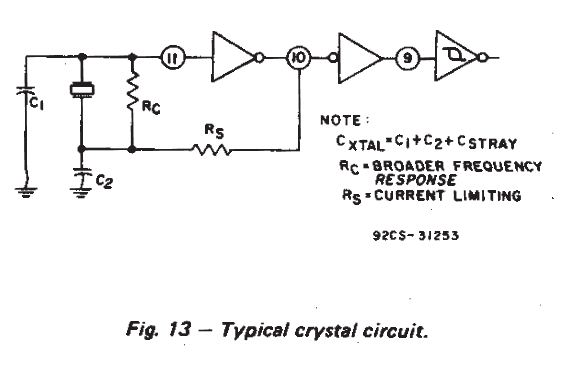

A CD4060 datasheet shows how to use a 32.767Khz crystal, and the crystals themselves are pretty common, since they are in almost all digital watches. If you look around they aren't that hard to find, even in an old watch laying around. You can probably buy a crystal where the CD4060 is sold.

Thanks, I got the IC and I got the crystal too (broke apart an old watch). But I don't know how do I wire them. Here is what the datasheet shows.
counter-jpg.37248
crystal-jpg.37249
Should I use external Gates or Are they already internally present? Which components should I add?
