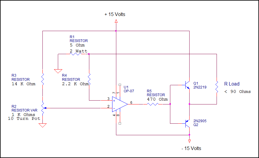

OK Following another fun filled entertaining work day the attached is an operational amplifier low current source (adjustable) I have used variations of for years. If you do a Google of Op Amp Current Source you will get plenty similar to this one.
The 5 ohm resistor is a sense resistor in the circuit. I would try and find a really accurate 5 ohm resistor in a 2 watt family. As drawn the circuit should produce -100 to 100 mA for a voltage in of 0 to 1 volt. Be it this circuit or similar I suggest a 10 turn pot for the Vin. That gives you much better resolution. Using larger transistors like a MOSFET or Darlington Pair will yield higher currents.
I am not saying use this circuit but rather snoop around (Google is your friend) and find a like circuit. You likely don't need the -100 mA to 100 mA so a single transistor and single ended supply could be used. All you want is a stable current source that fits your needs.
The idea here is as I mentioned. For example we want to measure the filament resistance of a standard 24 MB Lamp. We look at the data sheet and see it is a 24 volt lamp with a normal current of 73 mA. We know if we want to measure the resistance we need to keep the current low. So could adjust our current source and measure the voltage drop with maybe 5 mA flowing through the lamp. We measure the voltage drop right at the base of the lamp.

yes you can use a lm317 as a current source. i think they lose accuracy below 10ma.
an op amp current source or a lm317 with a shunt may be better.
you can control the current with any voltage so you can use a potetiometer or a dac to calibrate it.
build in a precision resistor as a calibration standard.
