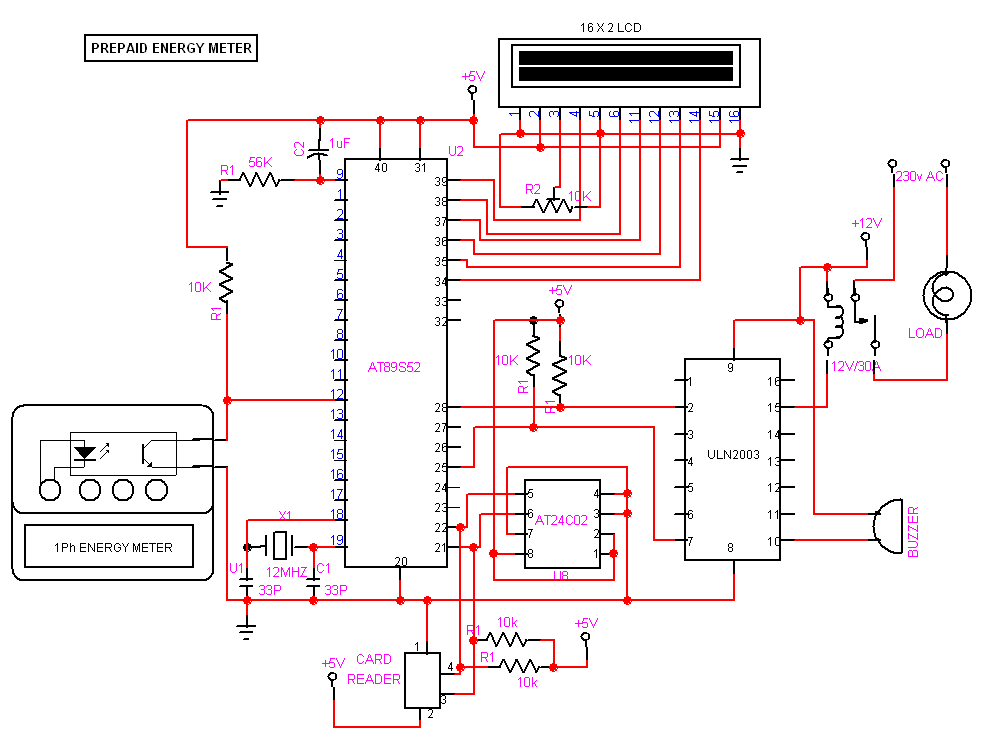

Hi there guys. I need help with the source code of the following prepaid energymeter circuit. Does any of you guys have the source code for it?
