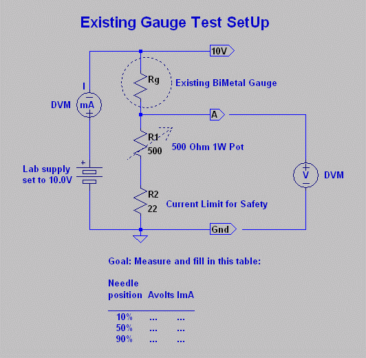

To proceed, you need to hook up this simple circuit and make the specified measurements:
Cheers Mike - OK - I can certainly do that, which I guess will give me the gauge's response curve. However, to date I've approached the problem from the other end and looked at the response curve of a properly matched pressure sensor/transducer for the gauge. Ohms law should hopefully give me the current flowing around the circuit.

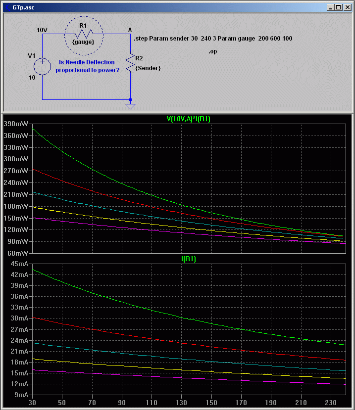

Follow my thought experiment:
The newer cars do indeed use a resistively-heated bi-metal to mechanically move the pointer on the gauge. These gauges are not your father's D'Arsonval meter movement used in early cars (and airplanes). The latest cars use stepping-motor movements.
The bi-metal gauge (I'm calling it a bmg) responds to the temperature of the bimetal. To a first order, the bending of the bimetal is proportional to its temperature. The temperature rise of the resistive heater above ambient is proportional to the power dissipated in the heater. Assuming the resistance wire that heats the bi-metal is constant (a big assumption if the heater wire is NiChrome), the power in the bmg's heater is proportional to the square of the current through it.
To eliminate ambient temperature effects, bmgs usually have three terminals: One tied to a regulated 10V, a second which goes to the sender, and a third to ground. I suspect that there are two heaters in the bmg; the pre-heater is wired between 10V and Gnd, and is used to "bias" the temperature above ambient, and the sender-heater is modulated by the sender resistance to create the needle deflection. The pre-heater might actually utilize a negative tempco in the wire to make the pre-heat start-point temperature somewhat independent of ambient temperature?
This little sim shows what I am talking about:
I am varying the sender resistance from 30Ω to 240Ω in steps of 3Ω (X-axis).
The upper plot pane is power dissipated in the bmg heater vs sender resistance at different heater resistances from 200Ω (Green) to 600Ω (Violet) in steps of 100Ω.
The lower plot pane is the current through the heater or sender vs sender resistance. (Same color scheme).
Note that the linearity of the power plot gets better at higher heater resistance, but is there enough heating of the bi-metal at ~100mW to make the needle move?

but that says nothing about needle deflection (which I suspect is proportional to gauge power), and that we know nothing about the spacing of the markings on the meter face...
True. If just going on the assumption that his existing gauge is known to work with a specific resistive sensor (old and no longer obtainable) in series with 10V and the only difference is that the new sensor has the resistance flipped, then how the gauge works should not be a consideration to my thinking.

Follow my thought experiment.....To eliminate ambient temperature effects, bmgs usually have three terminals.... I suspect that there are two heaters in the bmg; the pre-heater.....
No this has a single coil, without a preheater - I can absolutely confirm this having just restored this gauge and had it in bits for a while (see photo above). This is a pretty basic gauge even by classic standards! You're bang on that many VW/Willys gauges used a preheater to remove ambient temperature effects, but this one is no way near that 'advanced' - we're talking a coil/bimetallic strip assay attached to a pivot pin and tensioner - seriously this is not an accurate gauge at all :D
I do see what you mean with your thought experiment though.

I'm working on the interface between the old gauge and new sensor, but I really need to know how many mA it takes to make the old gauge read 10% of scale (just right of L), 50% of scale (N), and 90% of scale (just left of H).
Wow! Thanks mike - its just that I'm currently ill with flu (hence the reason I've been on here 24/7 rather than at work or out) - unless I can find a way to wing it with what I already have, a trip to the shops to pick up some components is a bit beyond me at present :(
OK I've finally managed to get hold of a pot of the approximately right value (1K) - the measurements are below, bear in mind they are very approximate given the gauge markings (or lack of them!)
High (100%) 4.67v 183.6ma
Mid (50%) 5.94v 137.7ma
Low (0%) 8.68v 70.2ma
R2 measured out at 22.3Ohms on my meter.
Interestingly it would seem that my gauge is of a different spec to others like it from Jaeger - doing some sums (R=V/I) gives me a resistance range of 123.6 - 25.5 ohms - very unexpected as my mate has a gauge exactly like this one that comes out completely differently!
