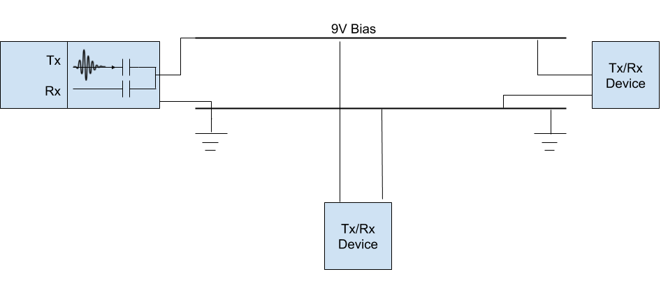

Im trying to implement an "intercom" system using microcontrollers for a PoC application. We have 1 common wire line biased at 9V and two or more intercoms each with a microcontroller based on Arduino. Each TX/RX intercom device can listen and talk on the common line. Im using a non electrolytic capacitor to "AC couple" RX and TX to the microcontroller. Im trying to prevent transmitted audio by a device from being received by the same device. i.e. if I talk I do not want to hear myself. Im hoping that there exist a simple solution or a IC that is made for this application?
A high level diagram is as follows:
Thanks,
StudentSA

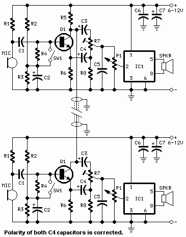

I think the solution is to use an opamp that will subtract your Tx signal from what you are reading at the Rx line.
Try researching "telephone hybrid".
Here is something which may give you a good start:
This circuit electronically cancels (adjust R7) your voice from playing in your speaker:
