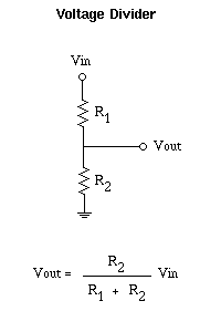

I just got into electronics recently. Is there a way to reduce current? I hooked up a circuit of two AA batteries and two 10K resistors on a breadboard, but the amperage isn't being knocked down, only the voltage. I want to hook up some LEDs, but the amperage in the circuit is way above the limit of the LEDs. Thanks.

A resistor will lower the current. It sounds like you might have made a voltage divider shown in my attachment. You should understand the concepts of parallel and series circuitry. For resistors if you connect two 100Ω resistors in parallel it will reduce the resistance to 50Ω. But if you had it in series it would make it 200Ω. If you have two LED's connected in parallel and they each take 10mA, you need to supply the circuit with 20mA. If you kept 10mA, each LED would take 5mA! Or if you have two LED's configured in series you have to double the voltage, so if one LED takes 3V and if you want two LED's, you have to have a supply of 6V (3V x 2 LED's). You should also look at the forward voltage of the LED's in the specs. A typical value will be 2.2V or something. So if a single LED takes 20mA, and you have a 3V supply, then 3V - 2.2V = 0.8V then according to Ohms Law, R=E/I so R= 0.8V/ 20mA which equals a resistor value of 40Ω.

Thanks for the reply! Yeah, I guess I need to read up more about series and parallel circuitry. I don't understand everything from the post but I'll read more, and soon enough I will. Thanks again, it's really appreciated.
No problem. All LED's have internal resistance, and that is what this Forward voltage is about. It will say Fv of 2.2V IF 20mA. So you know that if you have 20mA you'll have a forward voltage of 2.2V. Again, this is the LED's internal resistance, and since you want the LED to get as bright as it possible can, you subtract that from the supply voltage. You can't have a supply that is equal to or lower than 2.2V, it has to be higher than that. So you simply subtract the forward voltage from your supply voltage and divide that into whatever current you have (our example: 20mA).
