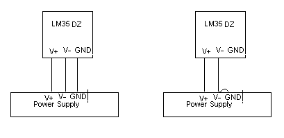

Hai, thank you for the post. The figure in attachment is the 2 ways I used to connect the LM35 to power supply. The left one show the direct connect of LM35 legs to the power supply. The second one I just connect the two V+ and V- to power supply then from the power supply, the V- connect to GND.
I actually try to follow the value in data sheet. But with the connection, when I tuned my voltage input to 4V, I need higher current (could be up to 0.3 A) and the LM35 itself is getting very hot and give high voltage output than expected. Is there anything wrong with my connection? Thanks.

Hai, thank you for the post. The figure below is the 2 ways I used to connect the LM35 to power supply. I actually try to follow the value in data sheet. But with the connection, when I tuned my voltage input to 4V, I need higher current (could be up to 0.3 A) and the LM35 itself is getting very hot and give high voltage output than expected. Is there anything wrong with my connection?
The LM35 if connected correctly only draws microamps and shouldnt even get warm at 5V.
Check that you have read the LM35 correctly from the datasheet.:)

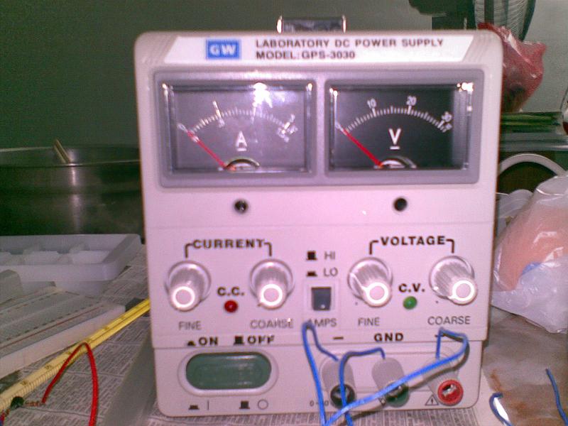

eric: you are fast replying while I manage to find the options. Yah, should be in microamps but when I increasing the voltage the CC light is on back from power supply. Is there any problems? Or is it better if I use three 1.5 V of battery to do the measure? The attachment is the power supply I used.
I posted my connection of LM35 as well.

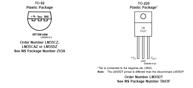

Where did you get those connections? Attached is the proper connection from the LM35 data sheet. Very simple. Plus and ground from your power supply, DMM red probe to out and black probe to ground. No problem.

Hi there, thank you for all of you help. I made the correction of connection of the circuit.
Actually, I made two mistakes before that. First is I thought the LM35DZ in data sheet is top view (didn’t notice there is a ‘BOTTOM VIEW’ there. The second mistake is I misunderstood the connection shown in Figure 1. Next time I will be more careful.
The V+ of LM35DZ should connect to + at power supply whereas the GND connected to -. Then use multimeter to connect at GND and Vout of the LM35DZ. Logic result will then be shown on the multimeter. Haha.
