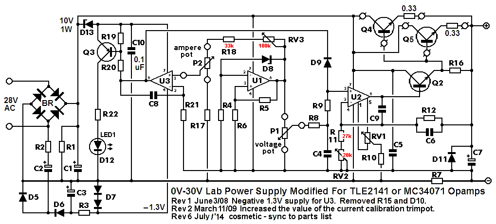

i found a circuit on internet i make circuit but it doesn't work properly i need some help please and i upload the circuit link on below
Total current path is not working when i just connect the BC327 the voltage through the collector shows zero only
even i switch ON the circuit the L1 & L2 glow at the time
and the Voltage circuit the out put is not varied
after i change the R8 in 1k resistor it varies some of the nearest value but its not accurate
That circuit is just odd. it does not appear to be a CC/CV power supply, but rather a CV Current limit with electronic fuse with no real way setting the value. It looks as if reset needs to be pushed to extinguish the overload light, so you should check that.

I think, if you pull Q3, Q6 and the wire between D1 and R13 you will just have a voltage regulator. I suggest you start there first.

My other intent is for you to remove the "components dealing with currnt" from what you have so far and see if you can get the voltage regulation to work. Add a fuse and you have a 30 V 3A voltage supply without electronic current limit.

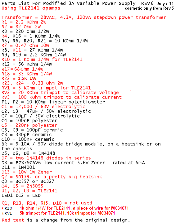

I fixed the defective 0V-30V, 3mA to 3A Lab Power Supply at www.electronics-lab.com because many of its parts were overloaded and its transformer voltage was too low for it to produce 30V at 3A.
The datasheet for the TL081 shows a maximum allowed supply voltage of 36V but in the defective circuit it has 40V or more. The MC34071 is no longer available in the through holes DIP package but the TLE2141 opamp is available and both have a maximum allowed supply voltage of 44V.
The TL081 needs an additional 5.6V negative supply voltage but the MC34071 and TLE2141 opamps do not. One of the new opamps uses a negative supply supply voltage of 1.3V because its output must go negative to drive a diode to reduce the output voltage when it is regulating the output current.
The fixed circuit has its schematic, parts list and pcb designs in the forum at Electronics-Lab.

but in my city both mc34071 and tle2141 ic is not available it will make my concentration destroy what will i do i search the combination in web i don't have no result what should i do ?
Did you look at www.farnell.com and click on the flag of your country? They have warehouses all over the world called "Element 14".
