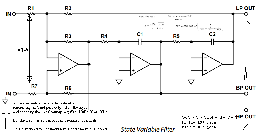

For a 2nd-order rolloff you can use a Sallen-Key filter with a dual-pot to vary the rolloff frequency such as shown here.
Digital potentiometers are shown but a dual-ganged manual pot will also work.
For an accurate crossover the satellite amplifiers need a highpass filter that matches the lowpass filter for the subwoofer.
You can certainly use the NJM072 parts. Design formula are pretty easy in attached.
